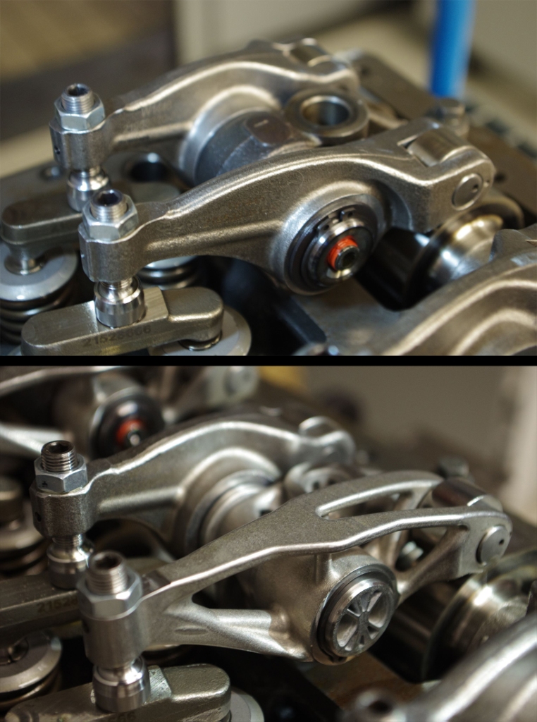

Although the complete engine was already designed virtually, rocker arms and camshaft bearing caps were manufactured by metal 3D printing and successfully bench-tested for 600 hours inside a Euro 6 engine.

Picture 03 : On top, a Renault Trucks Euro 6 DTI5 rocker arm ; above, a rocker arm manufactured by 3D printing on a bench test inside a Euro 6 engine.
