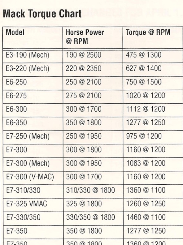

I'm not 100% on this, but I think the Mack torque figures were close to that of cummins, but obviously out of a smaller engine.

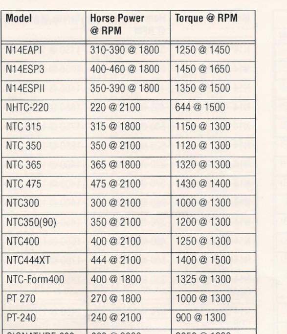

These are two charts from dw clutch. They say that the e6 350 put out more torque than the ntc400 cummins. Whether they are accurate or not I'm not sure, but it gives you an idea

Great chart, Timmyb.  Just what I was looking for.  Does your chart include the E7400 (did it get cut off)?  Or any other makes of engine to compare to?  Very interesting that the E6 350 and the E7 350 appear to have identical torque ratings.  Although it appears that there was also a version with a higher rating, just cut off at the bottom of the chart.

Click away my friend. Also if your handy with a google machine you can google dw clutch chart and put cummins, cat, Detroit, Mack, international and they will have a chart for you.
http://www.dwclutch.com/D&W/D&W Clutch & Brake 2/MACK TORQUE.pdf
So do all E6s have the same bottom end?  And all E7s?  It's just a matter of pump and turbo differences?  Interesting that E6 torque ratings range from 750 to 1277.  E7 torque ratings range from 1083 to 1660.  Quite a wide range on the same bottom ends, if that's the case.

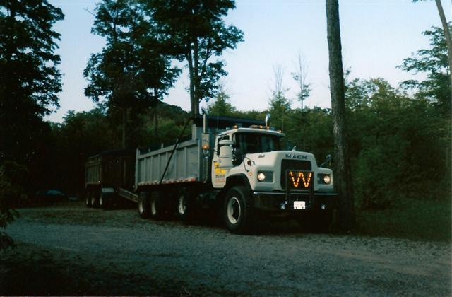

After seeing these numbers I'm wondering how I ever pulled 140,000 pounds up and down constant 8,10 and 12% hills here for all those years, with my little E6 350.
We even did a test on a 300 mile trip. And the E6 350 took less than 30 minutes more compared to a C15 475/1850.
This one is an 88, 4 valve and the odo has rolled over zero twice.
