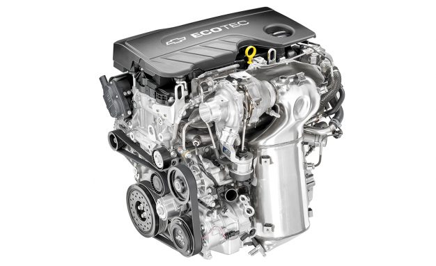

The Cruze's new lightweight 1.6-liter turbo-diesel engine will be optional on the Cruze hatchback and sedan.
Asked at the Detroit auto show about the Cruze diesel's highway rating, GM product development chief Mark Reuss said: "I think it will start with a 5."
The early 1990s Geo Metro XFi (rebadged Suzuki Cultus) is the last time GM had a non-hybrid car that had an EPA highway rating in the 50s.
The Cruze's new turbodiesel engine has an aluminum block and is rated at 137 hp and 240 pounds-feet of torque.

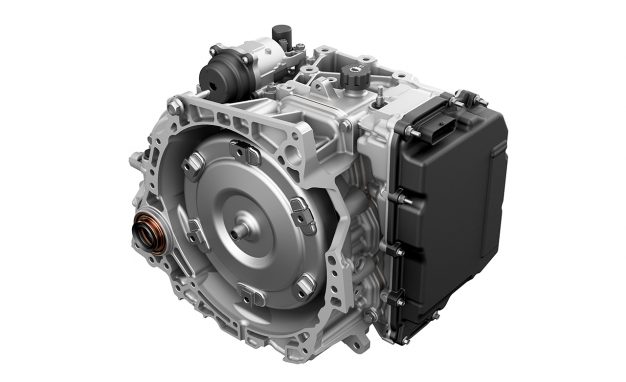

It will be offered with either a nine-speed automatic transmission or a six-speed manual. The Cruze manual will have a higher EPA rating than the automatic.
In 2015, the last time Chevrolet offered a Cruze diesel, the car had a 2.0-liter engine with a cast iron block paired with a six-speed automatic transmission.
With the 2017 model, most of the power comes on low in the rpm range. In addition to high fuel economy, engineers also concentrated on refinement.
"We've taken a totally different approach to address noise at the source," said Cruze diesel chief engineer Mike Siegrist.
The cam timing details, for instance, are at the back of the engine, instead of the front. And to keep diesel chatter low, the fuel injectors shoot as many as 10 squirts of fuel per stroke.

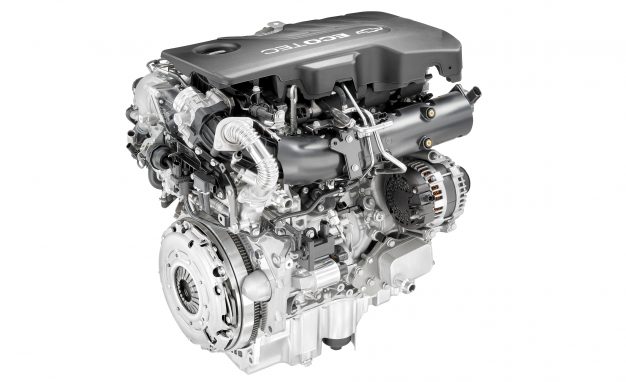

The Ecotec 1.6-liter turbo-diesel inline-four already at Chevy dealers in 2017 Cruze sedans and arriving shortly for Cruze hatchbacks and the 2018 Equinox and 2018 GMC Terrain was born and bred in Europe, where diesels have a much stronger foothold (mainly because of favorable fuel and diesel-car sales taxes). What GM calls its Medium Diesel Engine, Opel markets as a “whisper diesel,” touting its exemplary noise, vibration, and harshness manners. A GM plant in Szentgotthárd, Hungary, manufactures this engine.
Designers gave this diesel every advanced feature in the book. The block and head are aluminum to save weight, and crankshaft support is reinforced with a sturdy bedplate. Tough iron cylinder liners are cast in place, and the crankshaft and connecting rods are forged steel. Oil is sprayed onto the bottoms of the pistons to cool them. Two intake runners feed air to each cylinder; hinged flaps in half of the runners induce swirl motion within the cylinders. A 16.0:1 compression ratio provides the heat needed for auto ignition. An electronically controlled throttle regulates intake-manifold vacuum to manage exhaust gas recirculation and to expedite engine shutdown.
Both the cam cover and the intake manifold are molded fiberglass for noise absorption and to trim weight. The entire intake manifold is swaddled in acoustic padding and covered with a plastic noise barrier. Another noise-canceling measure was driving the camshafts from the tail end of the crankshaft so the gears and chains could be masked by the flywheel and the transaxle bell housing.
Ferrari has nothing on this diesel’s valvetrain. Two hollow overhead cams open four valves per cylinder through roller finger followers with hydraulic lash control. There’s variable timing for both intake and exhaust valves.
Ceramic glow plugs accelerate cold starting, and an optional oil heater is available for cold climates. The BorgWarner turbocharger is a variable-vane design for improved response at low engine rpm. Maximum boost is 27 psi. Solenoid injectors fed by a common fuel rail deliver up to nine squirts per combustion cycle. Oxidation and reduction catalysts plus a particulate trap cleanse the exhaust; diesel exhaust fluid (DEF) helps diminish NOx emissions.
Compared with larger-displacement predecessors, this Ecotec 1.6-liter engine is lighter, smaller, and significantly quieter. It delivers 137 horsepower at 3750 rpm, and the torque curve peaks with 240 lb-ft at 2000 rpm. That’s a bit less power but 36 percent more maximum torque than the Cruze’s turbocharged 1.4-liter gasoline engine puts out.

Most buyers will lean toward the optional nine-speed automatic transmission, which also scored an EPA combined mileage of 37 mpg. That Cruze powertrain earned 31 mpg on the city cycle and 47 mpg in the highway test.
