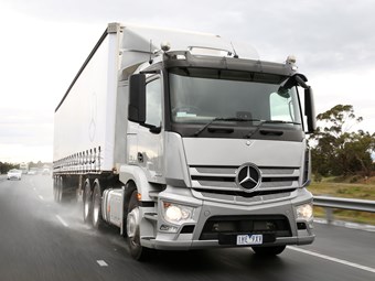

At the launch of the new Mercedes-Benz family several months ago, the 2643 was a real surprise packet during relatively short stints behind the wheel between Cairns and Townsville in Far North Queensland. Asked if the model could be made available for a test run in the more likely environs of country and suburban roads around Melbourne, confident Benz executives were quick to agree.
Consequently, the same sleeper model used at the launch program was provided for this exercise, hooked to a curtain-sided trailer and with a further 12,000 km on the clock following trials with fleet operators.
Gross weight wasn’t great at just 30 tonnes but then, it’s not uncommon for trucks pulling single trailers around the ‘burbs to spend much of the day at weights significantly less than max anyway.
Looking for a mix of roads and traffic conditions, the truck was pointed south-east towards Leongatha from the Whitehorse Trucks dealership in Dandenong, then across secondary roads to Gippsland’s Warragul before heading back through snarling suburbs to Dandenong. All up, 210 km of vastly different conditions starting with sodden freeways and fierce winds, and ending with a still, hot afternoon in congested traffic.
Yet just as it had done in Cairns, there was much to like about this truck from the get-go. For starters, it’s a short, easy climb into a cab that’s extremely practical and entirely comfortable. In fact, if there’s one thing that stands out in all the new Benz cabs, it’s the ease of familiarity. Switchgear and control functions are quickly understood and generally well placed, enhancing an internal cab design which is smart, neat, well-appointed and definitely driver friendly.
