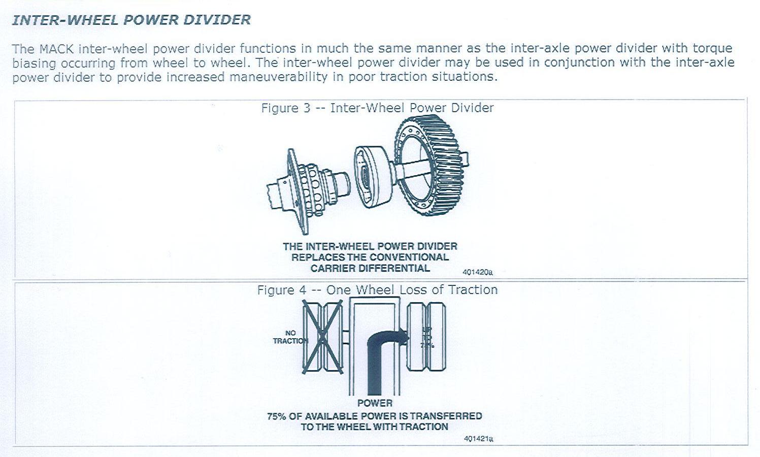

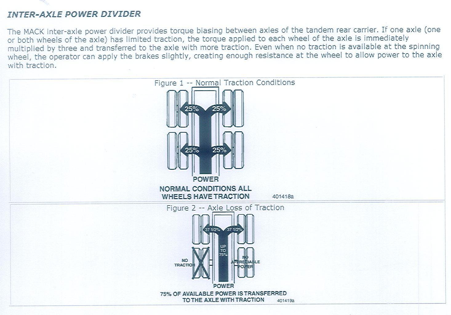

Your truck was ordered with the optional air-actuated inter-axle power divider lockout.
However, it was not ordered with the optional inter-wheel (differential) power divider (available on S38 and S44 bogies).
The Mack inter-wheel power divider, like the standard fully automatic command “wedge type” Mack inter-axle power divider, contains no gears and provides a 3-to-1 torque biasing capability to the left or right wheel with the best traction.
Hmm. Learn something new everyday. First time I've ever seen a tandem drive without both. Which kind of surprises me, considering the truck was bought for, and used solely in the Texas and Oklahoma oil fields its entire life. Its probably one of the reasons it has such aggressive drive tires on it.
I guess my next question is- does the system work like it's supposed to? I know like on old school 4wd pickups, if they didn't have a limited slip, the open differential almost always sends power to the wheel with the least resistance. Rather than to the wheel that could actually grab traction. But like in the explanation above, lightly applying the brakes should help control that.
