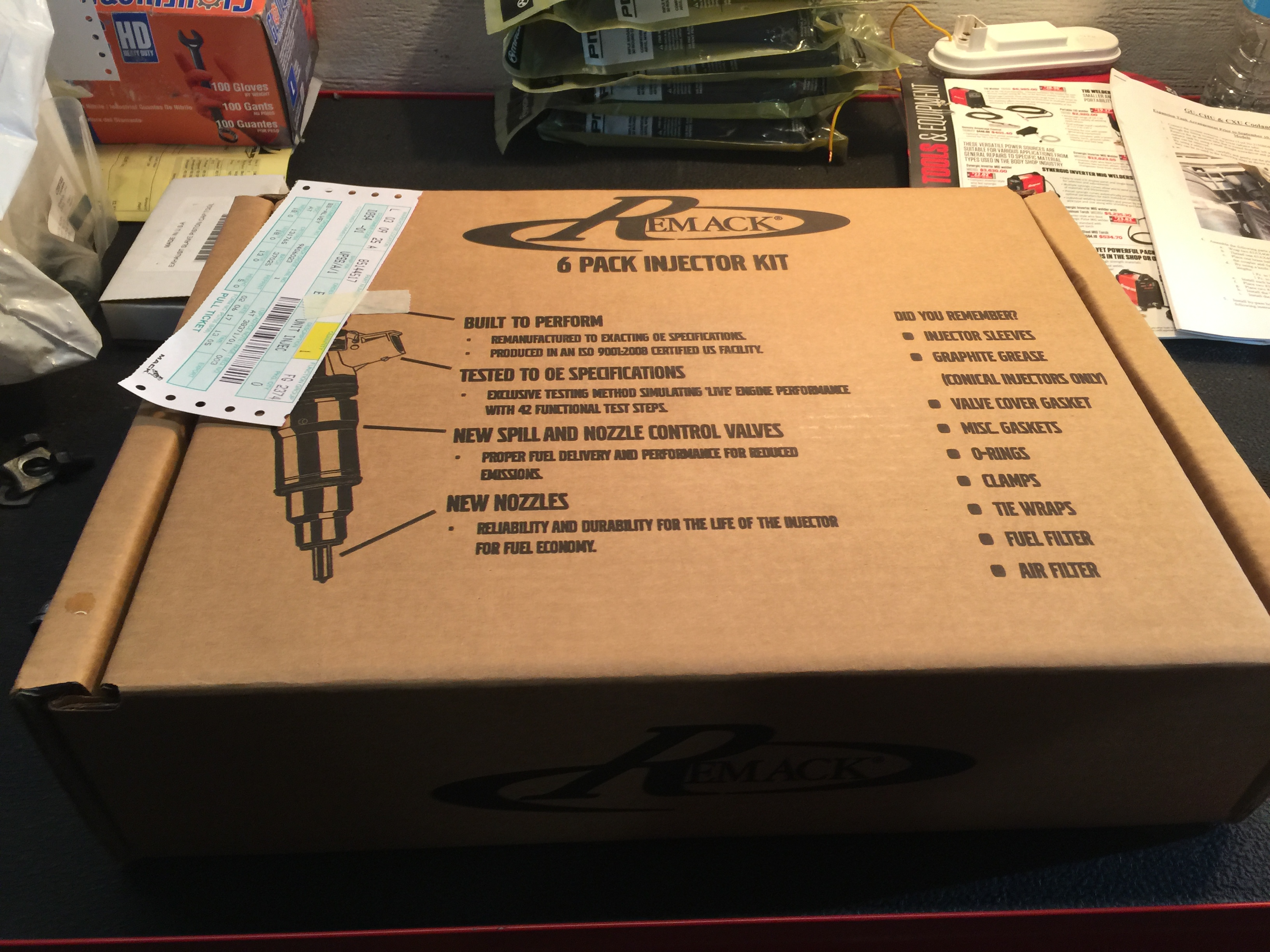

I will say, this is one of the best pulling trucks I have ever road in or drove. The owner picked me up and we took a load of corn to the grainery last friday.  Grossed out at almost 98,000 pounds and bad injectors we had no problems in the hills or in heavy traffic.  I thought it was awesome but he said it was no where as good as it usually is. Truck is a CHU daycab  with a 505 PLUS MP-8, T-310 trans , Meritor rears with 3.21 gears and disc brakes all the way around. Running super singles  on the back 445/50 R22.5 .  No speed limiting and he dont baby it at all and still getting 6.1 MPG on his trips.   I have pulled up some of his other longer and lighter trips and they were in the very high 7's .

Wouldn't it be nice if this fixes his problem for good!
