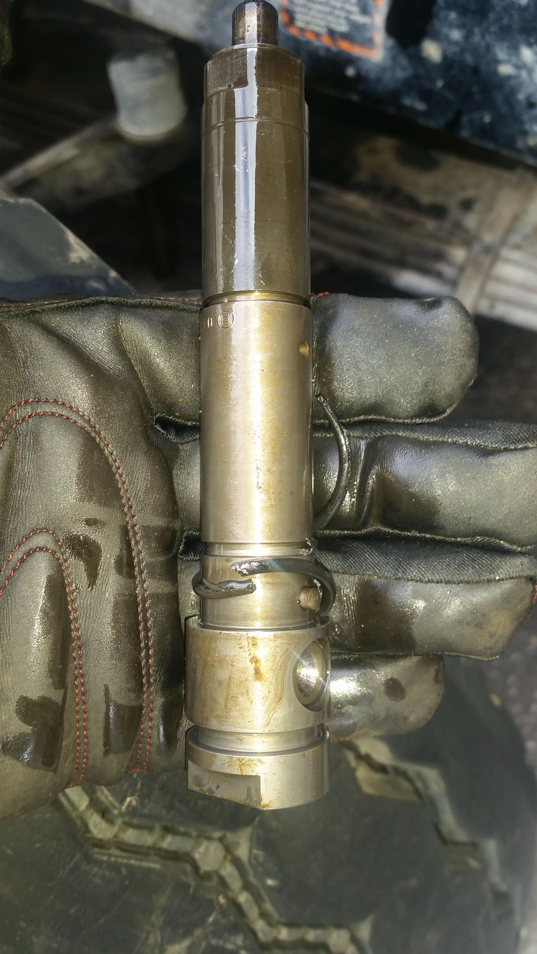

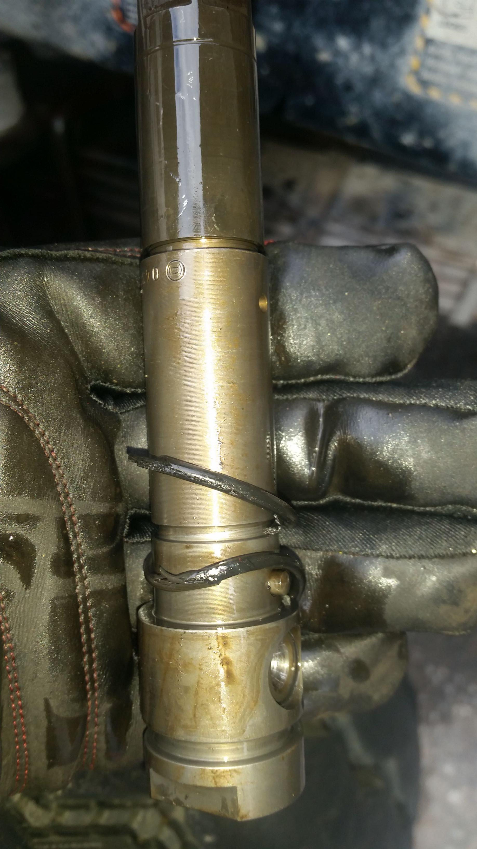

I had a fuel line, leaking #2 I first remove line, and put sealant tape, but I notice that fuel was getting in engine, when and got new line and install, new line that fix that problem, but I notice that when I start engine it kinds to has hard start, and some white smoke like when I install the new line and air got to the system, after engine runs, It clears up, but when getting to normal temp, and I'm loaded the engine has a miss, and I feel some power lost, now I check injector and #2 is little cold than #1, but not by much, now I turn engine off and let it cool for 3o minutes, and start again and it don't start smooth, it start a little rough, like in the morning but less,  I wonder if the transfer pump is going bad, or any body has any idea, I thanks you all for your help.

It is possible that your transfer pump may cause this symptom ! How ever sounds like an injector issue to me!
On 1998 to 2001 ETECHs , if fuel is coming out the head at the injector lines , then the o-rings on the injectors are leaking and return fuel is coming out around the injector line.  If the fuel supply pump is the original then I'd replace it. Low fuel pressure can cause some crazy engine misses that can jump from cylinder to cylinder
hey guys, well I when and took the time to remove the injector, and found that the O-rings, were blown out, bad, and the same time took injector to get tested, and found this injector got damage, my guess is that some Teflon tape got in the injector and plug the injector, got a new one and install, engine run, good, so never install Teflon tape on a leaking fuel line, just replace the line and remove the the injector to check O-rings, at the same time get it tested. I thank all of you  for your tips, sure help a lot,
