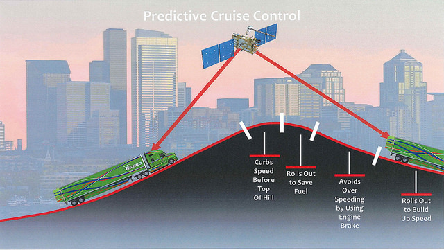

Kenworth’s Predictive Cruise Control combines GPS with cruise control to deliver the best fuel economy for the situation.  The system optimizes cruising speed based on topographical GPS data inputs. As the truck encounters certain types of terrain, such as rolling hills, the system modulated cruising speed to improve performance.
If, for example, a truck ascends and crests a hill, Predictive Cruise Control will allow the vehicle speed to drop slightly below the set cruise speed. This can improve fuel economy since the truck is using momentum instead of fuel to maintain the set cruise speed.
