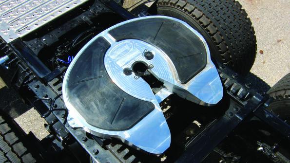

Redeker also says that SAF-Holland continues to design fifth wheels for weight reduction. Included are the aluminum top plate 55,000-lb.-capacity FWAL, the steel top plate 50,000-lb.-capacity FW17, and the LowLube version FW16. All of these fifth wheels can be mounted on the company’s integrated ILS lightweight slider or on stationary mounts. The ILS can also be used on the FW35 Series top plates.
“The FWAL top plate can save upwards of 100 lbs. compared to a standard-duty equivalent, and the cast steel FW17 and FW16 top plates are around 30 lbs. lighter than standard-duty models,” Redeker states. “When these top plates are combined with the ILS slider, fleets like bulk carriers wanting to increase payload can realize optimum weight savings.”
