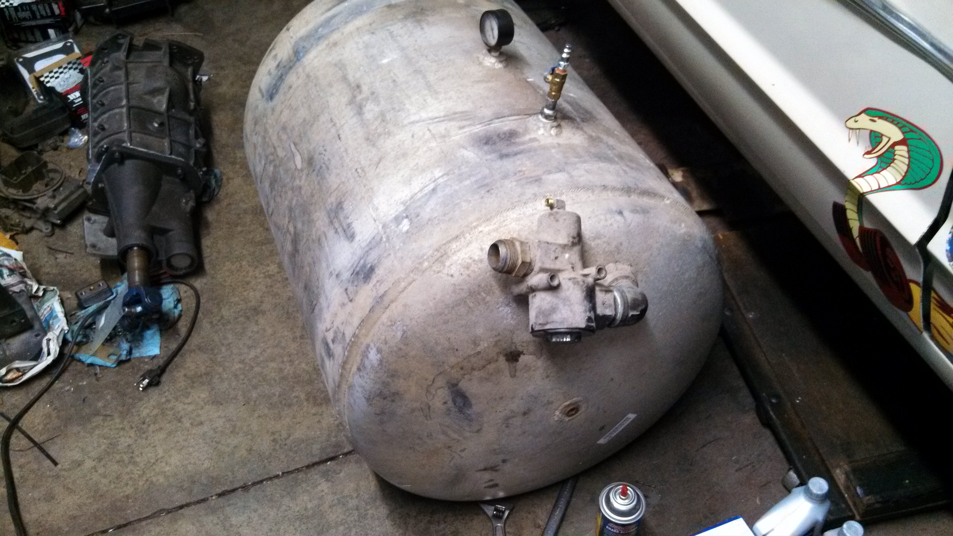

Well, I took the control valve off the orange tank and installed it on the other tank.  I installed a pressure gauge in one of the other fittings in the tank.  I filled it up to about 80# of pressure and marked the gauge with a sharpie.  We will see if tomorrow where the pressure is.  I did not plug the inlet side of the valve, I'm relying solely on the check valve to see if it is up to snuff.

So far this morning, still has 80# in it.  Didn't drop overnight, I'm leaving it til the weekend.  Looks like a keeper.  I'd really like an alum tank, but getting it to Ohio?  I wonder if the OD is the same as my steel tank, so it would work in my brackets?

I see the one has a threaded bung?  Is that air to the solenoid/starter?  Mine has a bolt on flange fitting.   Maybe that is how they do the aluminum tanks?
Larry
Well mine comes in about 26", using a level across the top and measuring down to the floor.  So yours would fit my brackets.  I forgot to look at my control valve and if I could convert it to thread on.  I'll check that this weekend.

No, both mine are just metal tanks.  Nothing inside.  The flange just makes for a nice sealing surface and a solid mount for the valve.  It's a four bolt pattern with split collar, typically I've seen for hydraulic hoses.

Well, I now have an aluminum air tank, thanks to Mark.  I have my brackets getting powder coated.
I aired the tank up to see how it held.  It leaked down pretty fast so I picked up a renew kit for the valve today and I'll get that assembled and retest the tank this weekend.  I'm pretty sure it should be okay now.  I also ordered an air push button to operate the valve.  Never guess how hard those are to come by these days.   Cross truck didn't have it, Freightliner didn't have it, Mack didn't have one.  I ended up back at Freightliner as they seemed to be the most responsive about actually wanting to order it for me.  The lady behind the counter was actually "giddy" about air starters.  She says every time she watches Maximum Overdrive she has to rewind it a couple times when the old White wrecker starts!!!  I told her I know the movie well.  I might have to drive the truck down and let her hear it once I get it put on this summer.

I got the valve rebuilt this morning and aired the tank.  I tried the valve using my blow gun.  Wow....that makes a hell of a bang of air out the hole!!  Guess it works.  I will check back tonight to see if it is holding pressure.
