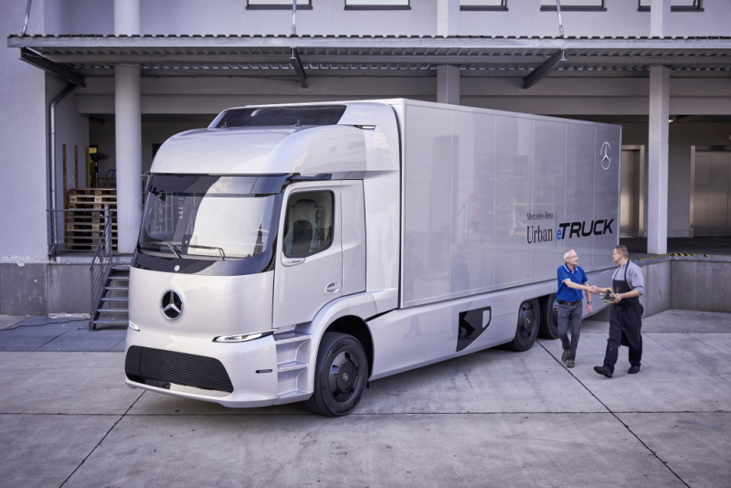

Mercedes-Benz Trucks is bringing its all-electric heavy-duty truck (earlier post) to market in a small series this year. Following the presentation of the Urban eTruck with 25 metric ton (55,116lb) GVW and a range of up to 200 km (124 miles) at the International Commercial Vehicle Show in 2016, the first vehicles will be delivered to customers this year.
The electric truck is based on a three-axle truck, with the entire conventional drivetrain replaced by an electrically driven rear axle with electric motors directly adjacent to the wheel hubs. Maximum output is 2 x 125 kW (2 x 168hp), while the peak torque is 2 x 500 N·m. In combination with the gearing, the torque at the wheel reaches 11,000 N·m.
The power is supplied by a battery pack consisting of three modules of lithium-ion batteries with a total capacity of 212 kWh. This results in a range of up to 200 km (124 miles)—normally enough for a typical day's delivery round. Depending on the desired range, the modular battery pack can be customized by adding or removing batteries.
The Urban eTruck is connected to the charging station using the Europe-wide standardized Combined Charging System (CCS) Type 2 connector. With a charging power of 100 kW, the fully discharged batteries are charged to 100% in two to three hours. (The system will support up to 150 kW.)
