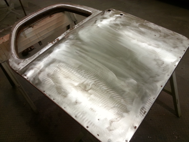

Hmmm, I've got a set of factory bare NOS door shells.  I have wondered what they filled the spot welds with?   Just paint?  Or some kind of filler?  I've never got them painted and put on my truck, yet.  Too nice actually for my rust bucket.  I have one nice extra passenger door that I was going to strip and use instead at some point.

There was nothing filling the spot weldd at all.....just primer and paint.

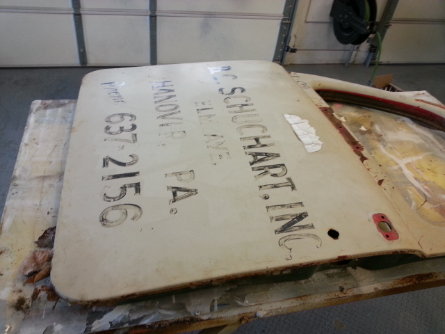

Ha!  I remember that company.  I grew up in Hanover PA.
It was originally sold to The Kelly Company according to the factory build sheet in 1958. I was able to see some of the original lettering on the tank as I was stripping the paint off.
I tried to get some info from both companies about the truck.....maybe an old picture or something. No response yet.
the spot welds weren't filled and they weren't from the front. they were spot welded around the inside. the dots you see are from rust pulling at the seams. overallan excellent door tho. skim coat of icing on those dots and some primer and good to go. when I usually do a B model door as dumb as it sounds, I usually pour a little oil or fluid film inside the door before I put the door panel on.

My new doors have a very noticeable dimple, like Willies.  That is why I was asking what they used from the factory.  It would take a decent primer coat to fill them level.
I agree on the Fluid film.  Keeps moisture from tearing into the seams.  I do my daily drivers twice a year with Fluid film.
I think they used to deliver heating oil to our house in the late 70's.  I'll ask my folks.

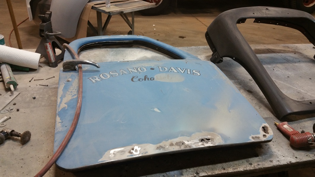

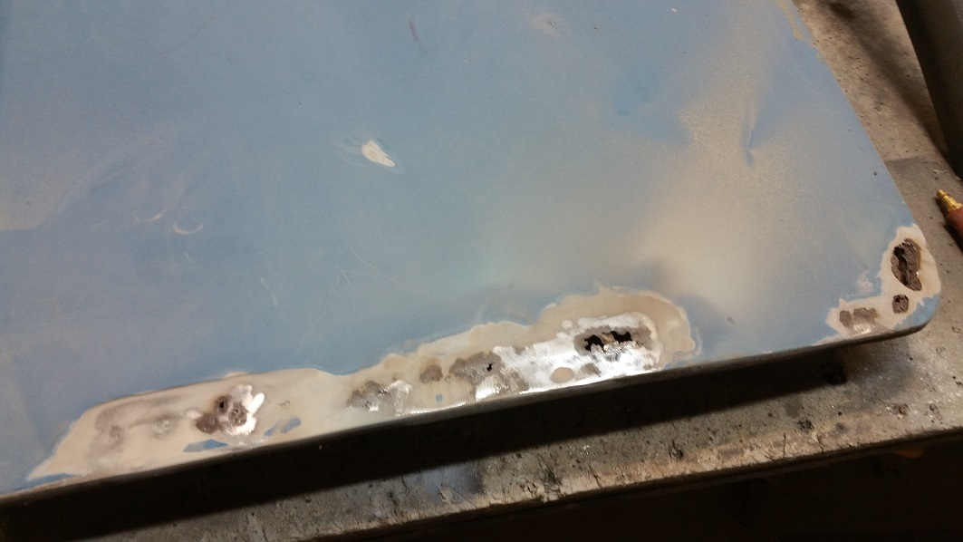

I wasn't as lucky
