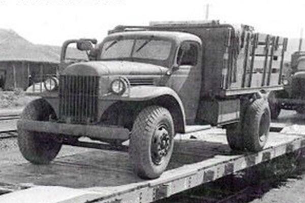

Many of us are familiar with both the civilian and military Dodge trucks of the past. However one model that is often forgotten is the military issue model T-234.
During World War II, the 2-1/2 ton rated Dodge T-234 was used in the India Theatre for the construction of the Ledo Road* (1942-1944), a critical supply route after the Burma Road was cut off by the Japanese. The project was led by U.S. Army General Joeseph "Vinegar Joe" Stilwell**.
https://en.wikipedia.org/wiki/Ledo_Road
**  https://en.wikipedia.org/wiki/Joseph_Stilwell

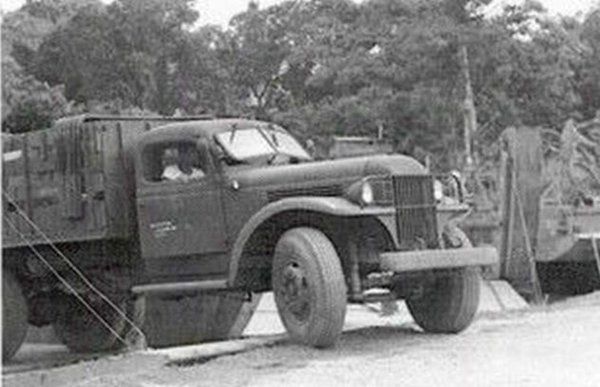

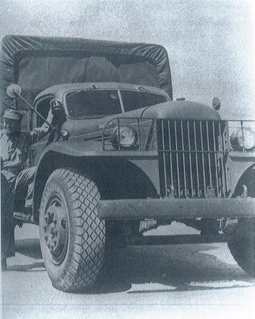

Although built with the standard civilian Dodge cab and hood, the front fenders, grille and axle were different from U.S. models.
The T-234 was equipped with large 10.00-20 tires, and had a 170-inch wheelbase.
Dodge's 228 cubic inch L-head model T-203 engine, rated at 99 horsepower and 188 lb/ft (255 N.m) of torque, powered early models. Later, the 128 horsepower 331 cubic inch engine was fitted.
The T-234 was right-hand drive, as the British were responsible for India and Burma.

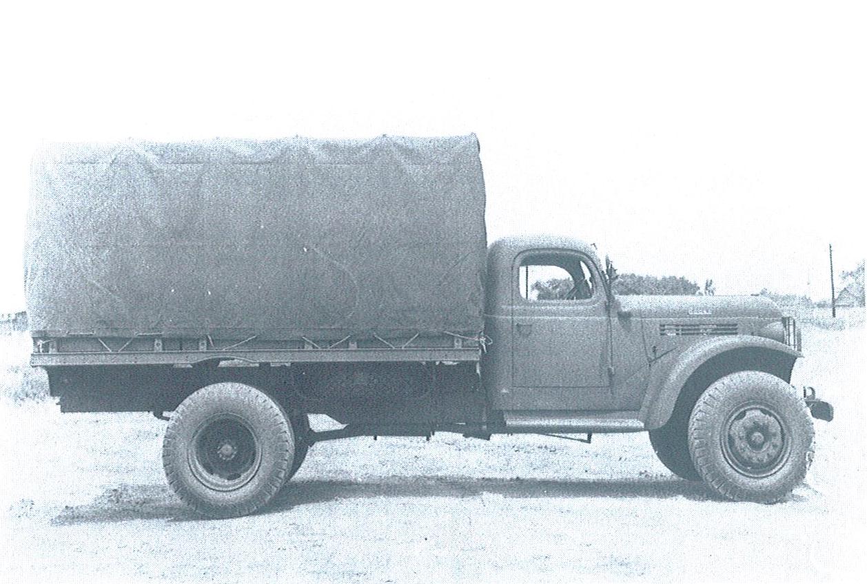

Remember, the lighter Dodge T203, many of which were supplied to the Soviet Union under Lend-Lease, was only rated at 1-1/2 tons.
This T234 variant was beefed up considerably to have a 2-1/2 ton rating alike the much more substantial Diamond T Model 614, International K6 and K7, Federal Model 2G and GMC ACX.

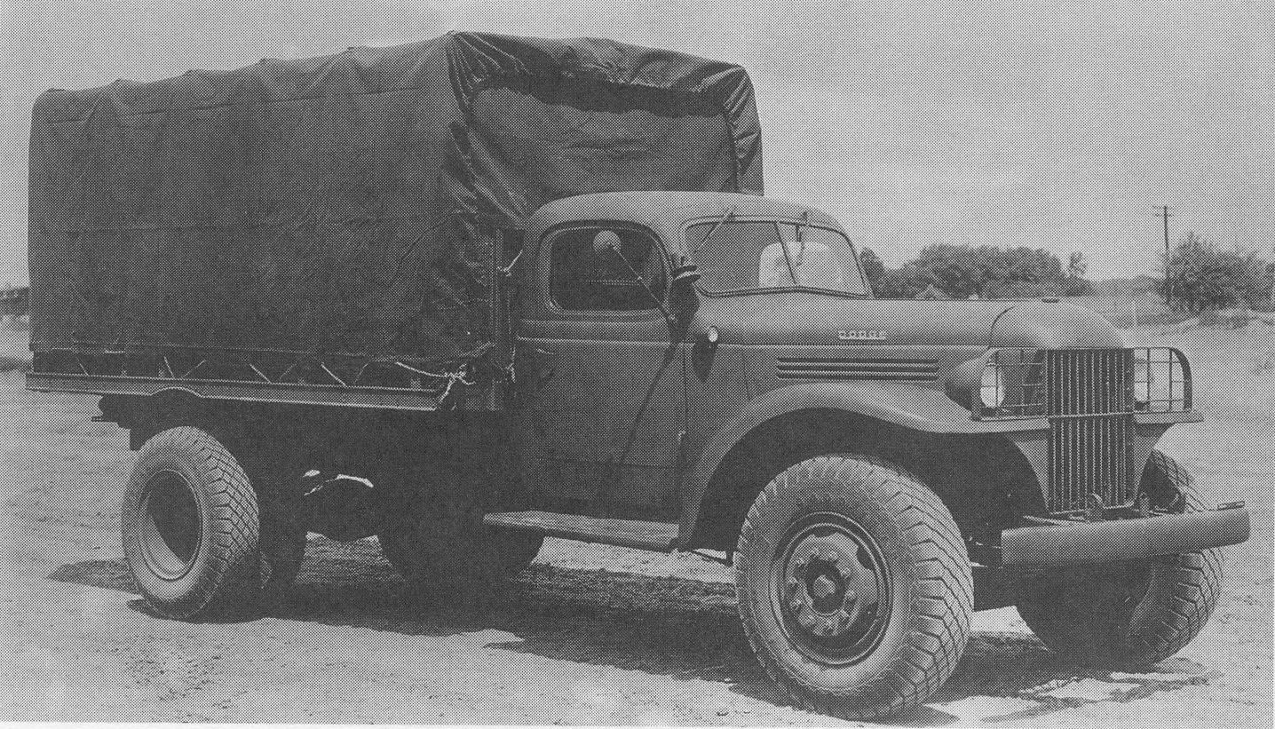

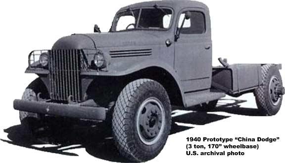

Dodge T-234 "China / Burma" truck
A special case in between stock commercial and dedicated military trucks, was the T-234 "China / Burma Road" truck, which was built as part of the Allied cooperation with China against Japan, in the war and just thereafter. From October 1944 through March 1946, Dodge built 15,000 trucks, that used a special order combination of their most heavy-duty off-the-shelf components, to overland supplies from India to China over the very rough Stilwell / Ledo Road, to an extent to specifications personally drawn up by Generalissimo Chiang Kai-shek, then commander of the Nationalist Chinese forces. Chiang Kai-shek asked Roosevelt himself for 15,000 two-and-a-half-ton trucks capable of handling the Burma Road, requiring them to have an engine of at least 300 cubic inches and a 5-speed transmission.
The trucks were built with a near standard civilian closed cab – right-hand drive because the British were in command of Burma – but fitted with a flat, military-style grille & brush guard, and wide open, almost flat fenders, to avoid mud build-up clogging the wheels rotating, and otherwise stood out by having a 60-gallon fuel tank. In order for the trucks to function on the grueling 4,700 mile journey over the Himalayas, Dodge fitted not only heavy-duty springs and steering gear, but went so far as to fit tri-metal aircraft grade bearings and aeroplane-type shock absorbers. Radiators were fitted with an overflow tank, to return the cooled water to the sealed cooling system. Ground clearance was 13 in (33 cm), with a 50° approach angle, and 28.5° departure. Front axles were widened to give wider tread. Nevertheless, the average life of the trucks was only about five trips.
It has been commented that the front sheet metal design of the T-234 Burma Dodge shows remarkable resemblance to that of the post-war Dodge Power Wagons, and may well have influenced it.

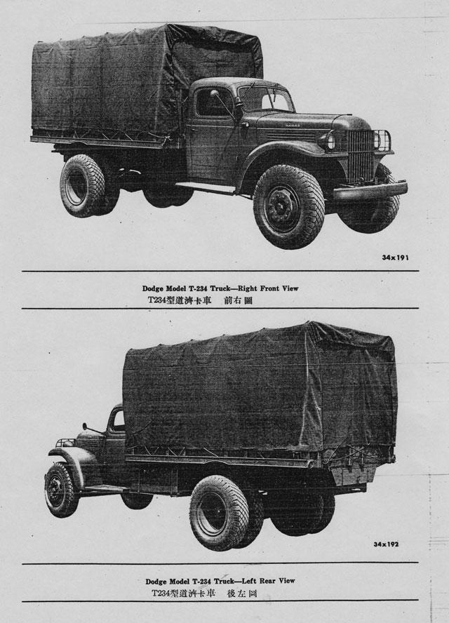

I'm reading the rear axle of the T-234 was a Timken full-floating single-speed double reduction unit with an 8.4 ratio.
The transmission was a Clark direct drive five-speed with a 7.58 first gear, and 6.10 reverse gear.
Curb weight  9,910lb
GVW (GVM)  20,000lb      (I'm sure that was routinely exceeded)
