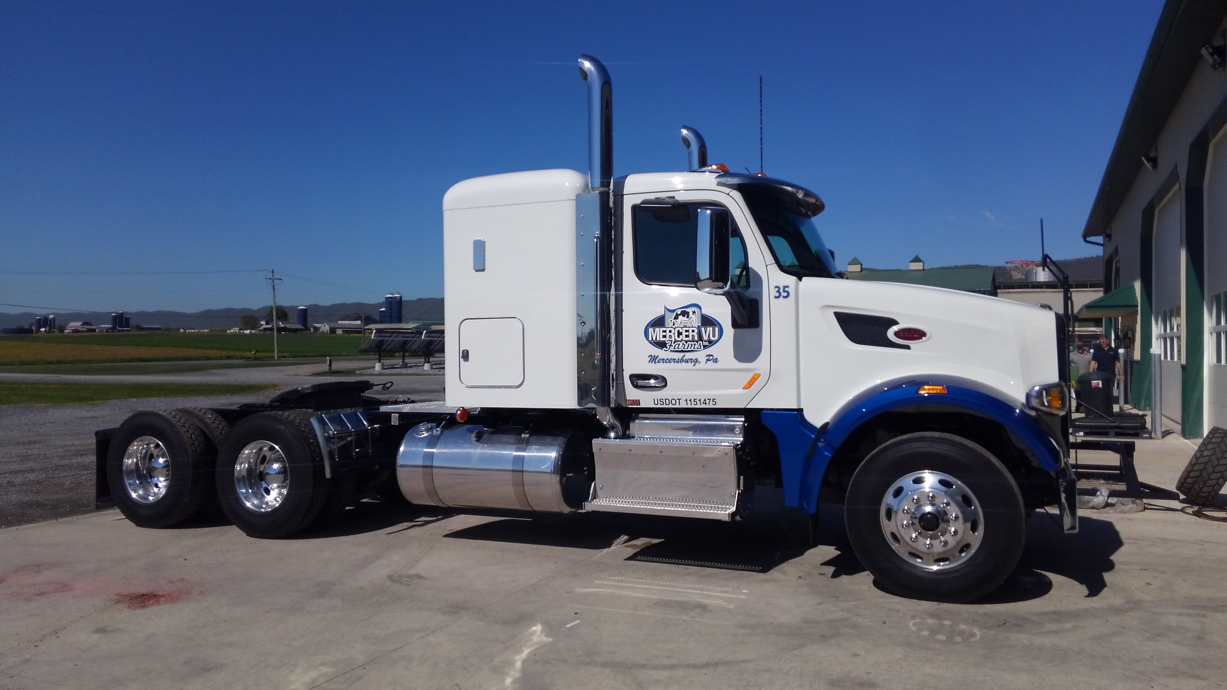

Sorry to say it, even though we like macks, but the owners, myself, and my dad decided we like the new pete 567 better than a new mack at the moment so thats what they went with.
Paccar 455/13speed/3.42. Pulls very nice, pulls just as good if not better than our mp-485 and 14liter/515 detroits. So far fuel economy is about 6.4 to 6.7, can't wait to see what it is broke in.  We were very interested in a new chu, but pete salesman brought this around and pretty much changed our minds on the spot. We even test drove it with a load before the deal was made. Just like logtruckman said it's a nice mix of modern and old school. One thing i like is pete still uses standard pipe thread air line fittings instead of the special whatever thread fittings mack/volvo uses.
