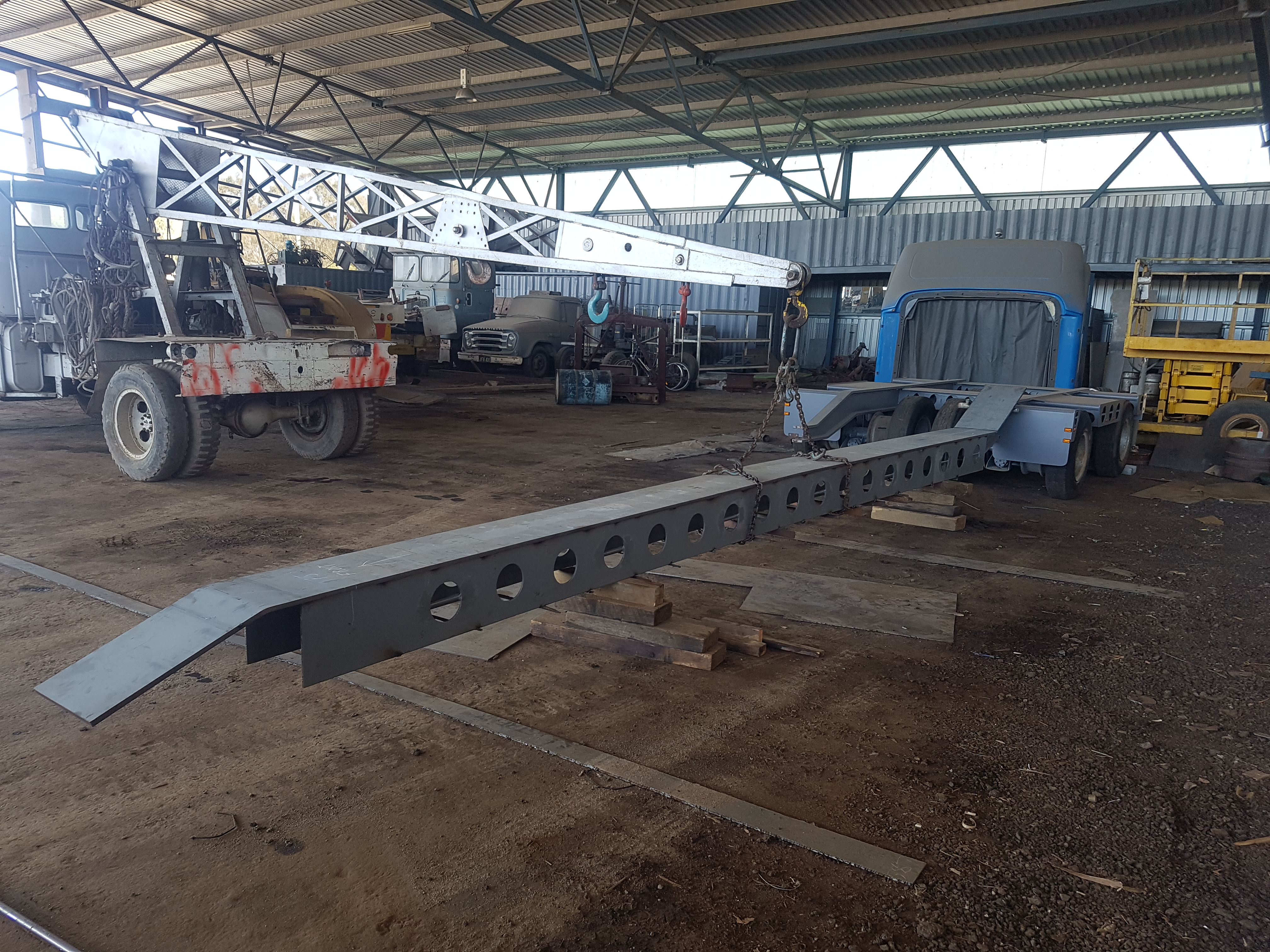

Gudday M8
we R gunna knok one out
but jist wunder n wot holds the RSend right in @ narro or right out @ max width
not sure if the expando ram air/hyd is under pressure to keep m in or out @ max pressure
or is it set then the load holds it in the desired position

That jigger is 8'10" (2.7m) at the deck
(Not shown is the 2 air rams to suk in or out the RSend)
the lawman sez:
Rows of 8 (LowBoys) LowLoaders can run around MT or loaded at that width
2x8 ... 8'10 (2.7m) wide ............ widespread at 6' (1.8m) wheel centers we get 24 ton
we then widen the RSend to 11'5" (3.5m)  we get 31 ton on RSend
11'5" (3.5m) is the cut off point B 4 escorts etc
hope n to B light weight trailer
Part 2 will have a 20' (6m) sliding deck extension
Part 3 will have a third axle pind on ............ run n on air bags .....max  then 42ton on RSend
Plus a choice of jeeps (dollies)  ...1x4....1x8....2x8
thanx fir u're interest
