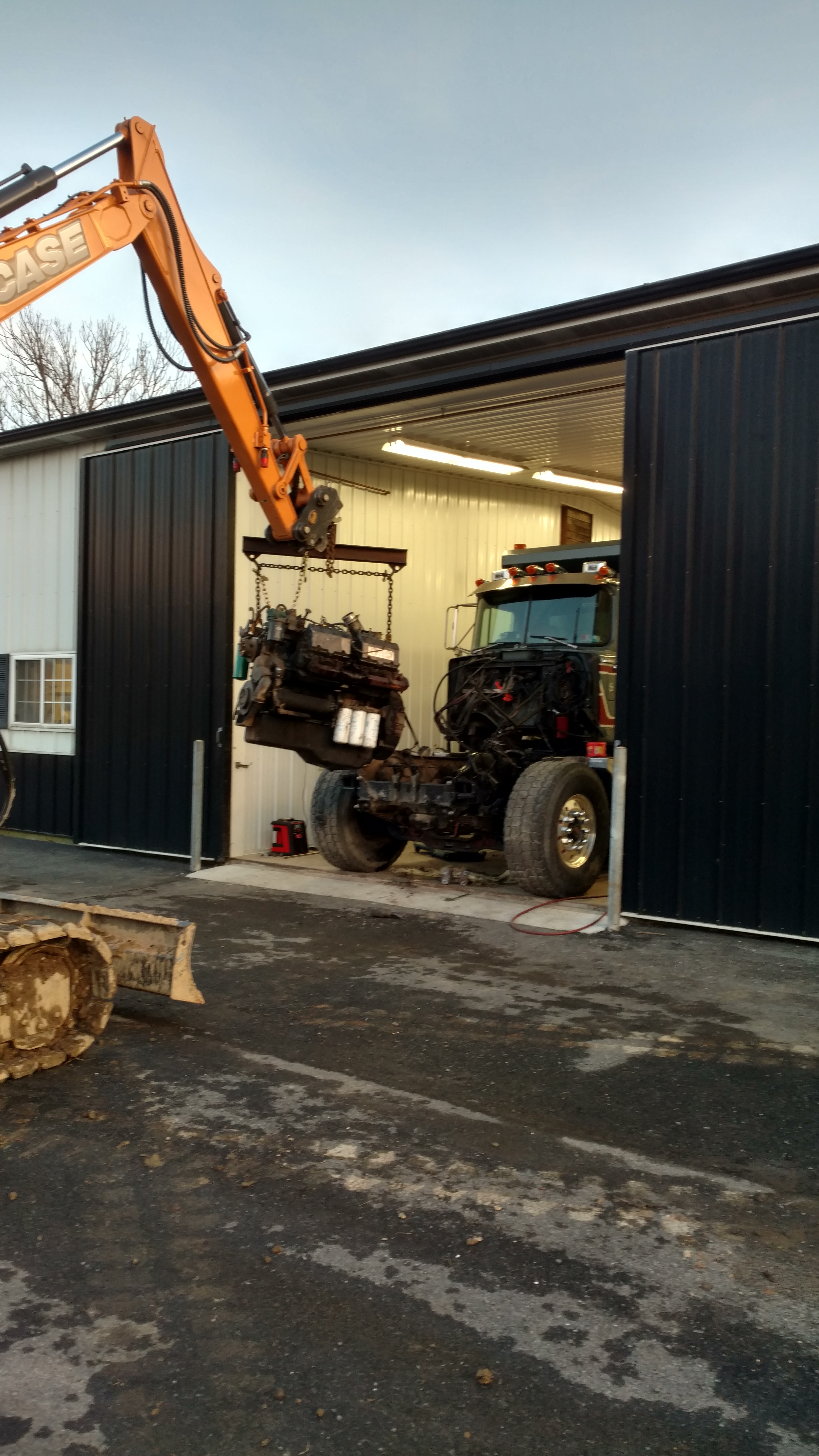

Hello.all, I recently pulled the E-9 500 out of my Superliner triaxle dump to have it rebuilt. The builder tore it all down and sent everything to the machine shop to have it cooked and checked out. What we discovered was that all the components looked good except number 4 counterbore is cracked. So if anyone knows where  I can find a good block your help would be greatly appreciated. I'd like to get it back to hauling as soon as possible. Thanks
