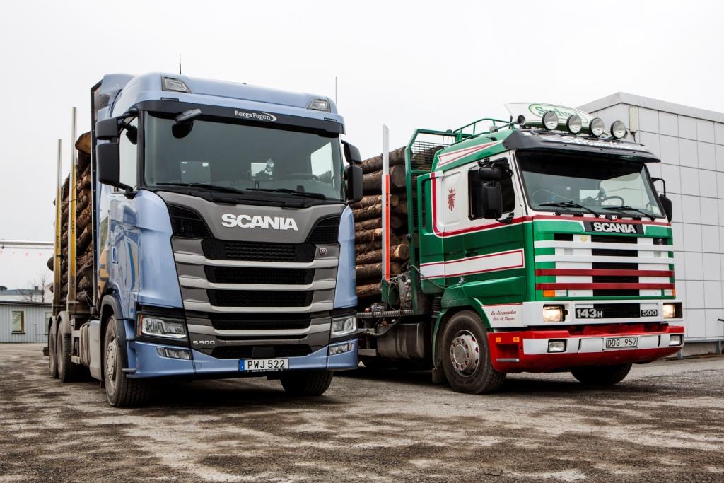

Rather than guessing about the development over longer periods of time, Scania decided to ask powertrain-testing company AVL to conduct an independent test. The company measured fuel consumption and nitrogen oxide emissions over six identical 140-kilometre test drives of a 25-year-old Streamline 143 and a newly manufactured New Generation Scania S 500.
Both vehicles were designed for timber transport and had 500 hp engines. The older truck had a V8 engine with a displacement of 14 litres, while the new truck had a straight six with a displacement of 13 litres. Despite its smaller size, the new engine was more powerful at all engine speeds.
“We did it this way [using a straight six] because both vehicles reflect typical timber transporters of their day,” says Wentzel.
The test drives took place at the beginning of February 2017. The 143 was in very good condition and was on exhibit at the Scania museum in Södertälje prior to the test. Apart from a necessary update of its tyres, it was effectively in the same mint condition as the S 500. During testing, the vehicles were driven at 85 km/h on the same stretch of Swedish national road 73 south of Stockholm, at the same time, and by the same two drivers. They had the same cargo weight, which gave the new vehicle a small advantage as it was lighter overall.

So, what did the test results show? They turned out to be in line with developments since 2004. In the 24 years between the production of the two trucks, fuel consumption fell by about 25 percent. Nitrogen oxide, meanwhile, fell by 95 percent.
