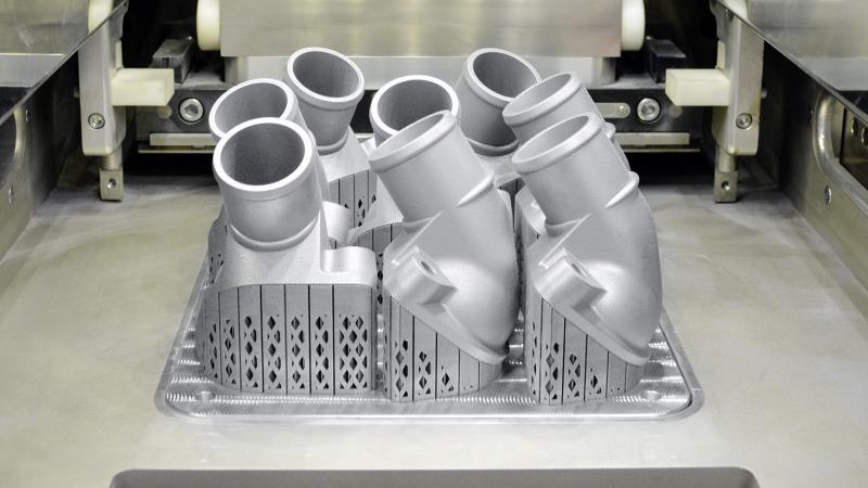

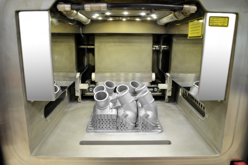

Mercedes-Benz Trucks has introduced its first 3D-printed spare part made of metal (an aluminum-silicon material), a thermostat cover for truck and Unimog models from older model series.
In contrast to the Selective Laser Sintering (SLS) process used in plastics 3D printing, 3D printing of metallic components uses Selective Laser Melting (SLM). In the case of the thermostat cover, for example, the powdered aluminium/silicon material (ALSi10Mg) is applied in individual layers and melted by an energy source—usually one or more lasers.
When one layer is completed, a new layer of powder is applied automatically and the melting process is repeated. The process is repeated until a high-strength, three-dimensional aluminium component suitable for use in areas of high temperature has been produced. With the layered structure, the process also offers a level of geometrical freedom that cannot be matched by any other production method.

As 3D printing technology continues to find real-world applications in automotive and trucking, Mercedes-Benz Trucks has opened new possibilities with an announcement yesterday that it's now printing metal spare and replacement parts.
That follows up on the OEM's plan to begin 3D printing plastic or composite spare parts for certain European market trucks in late 2016. It may have seemed a move that would have limited applications or advantages, but the company's expansion into new materials could offer more.
For example, Mercedes-Benz noted that the first metal parts it's printing are aluminum, and "these excel with almost 100% density and greater purity than conventional die-cast aluminum parts." The 3D printing process could deliver items with a material/ structural advantage, which has also been touted in using the technology to make things from plastic and similar materials.

Daimler Produces its First 3D-Printed Metal Part
Heavy Duty Trucking  /  August 3, 2017
In Europe, Mercedes-Benz Trucks has printed its first spare part made of metal that has passed all stages of the company’s quality assurance process.
The 3-D printed part was a thermostat cover for older series Mercedes-Benz truck and Unimog models. Daimler said this was the first time the company was able to print a strong metal version in original quality.
