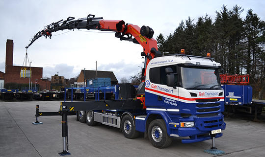

There are two artic Scania R490 and two rigid R450 units, all equipped with Palfinger cranes.
The two 8x2 rigid vehicles with PK65002-E cranes feature a hoist attachment that can lift 3.2 tonnes to a distance of 16.6m.
The addition of a fly jib means loads of up to 0.8 tonnes can be lifted to a distance of 28m.
This weight and distance can also be achieved at a distance of 12m from crane centre with the ability to lower the load straight down to ground level with the hoist.
The units also have a stabiliser installed at the front of the vehicle to give greater support to the crane when operating over the front of the cab, when the fly jib is in operation.
