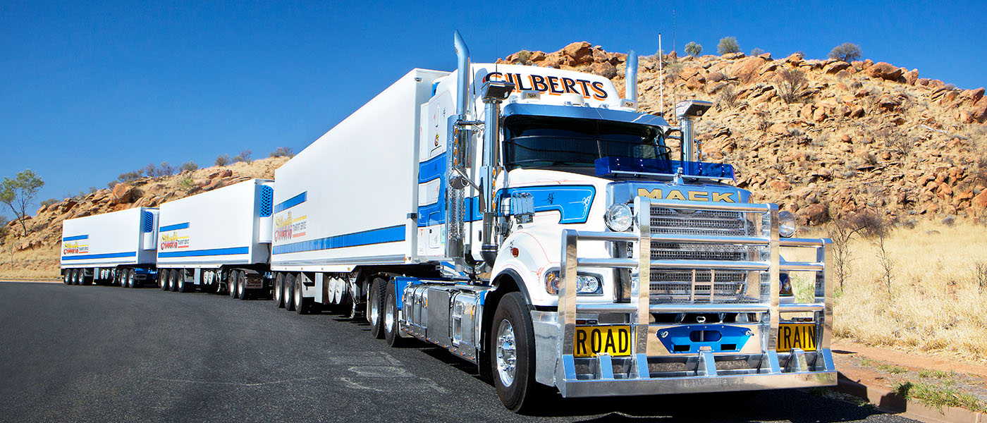

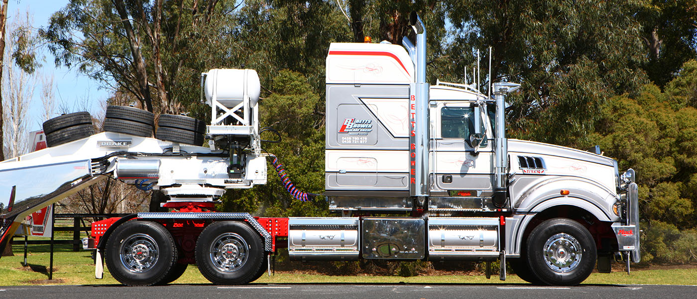

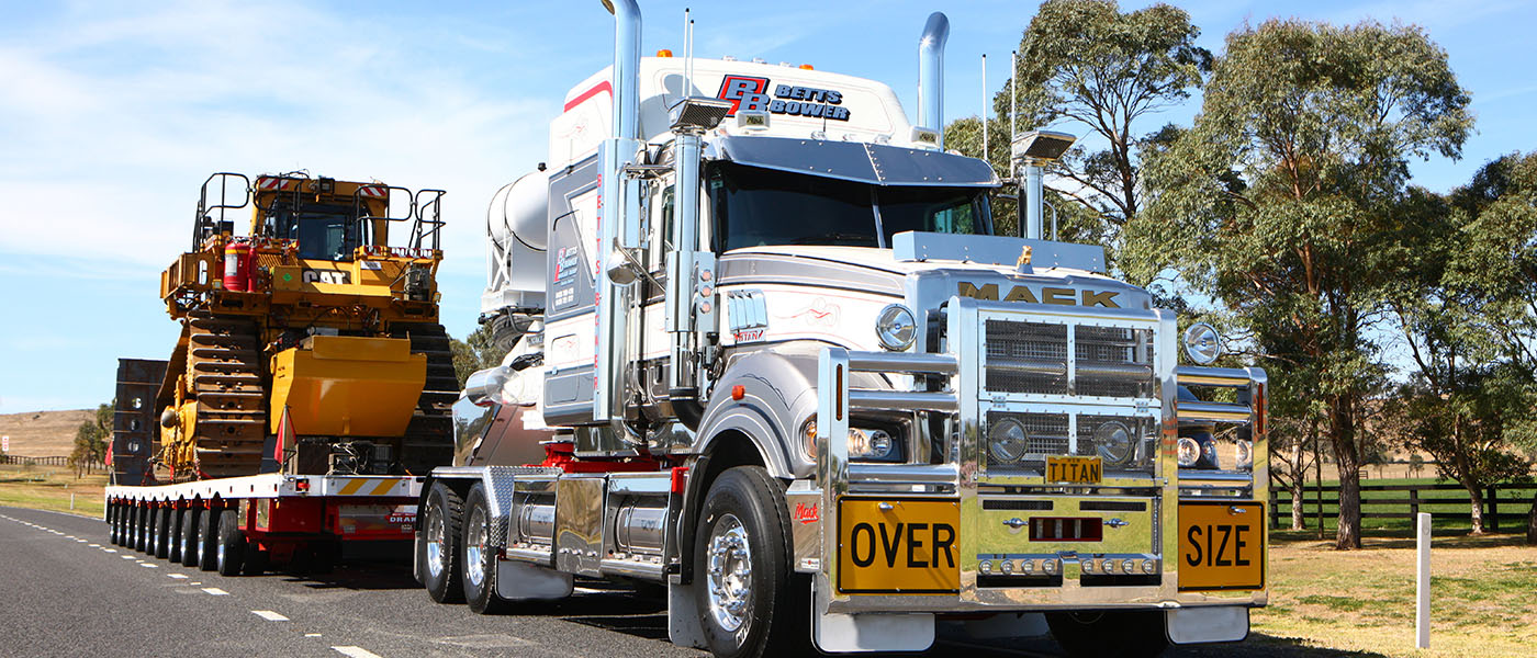

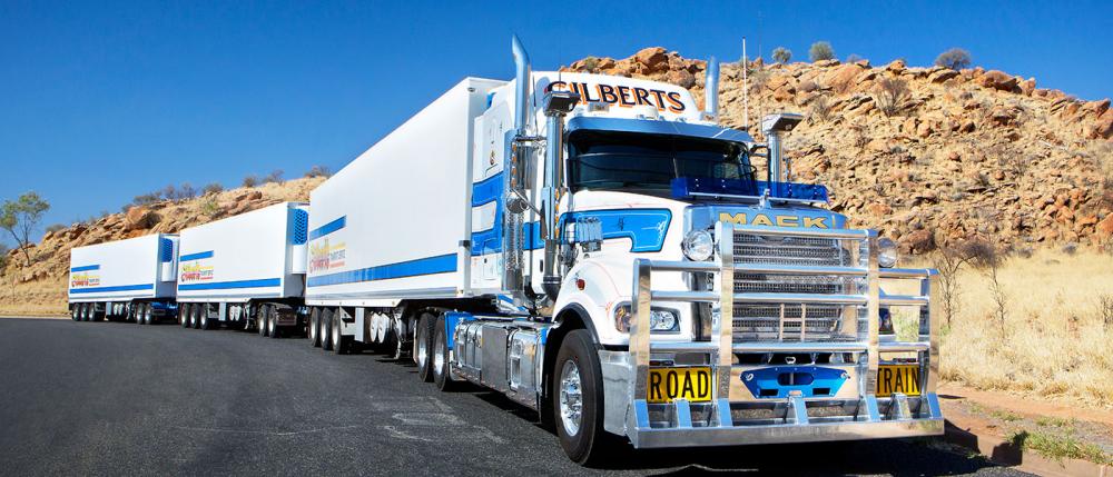

The "original", the Australian market Titan, looks so much better, without for example the tacky US market gray plastic fender extensions, chrome grille and headlamp trim, and front bumper. Volvo visibly decontented this truck for the US market.
Ref.  https://www.macktrucks.com.au/trucks/titan/
