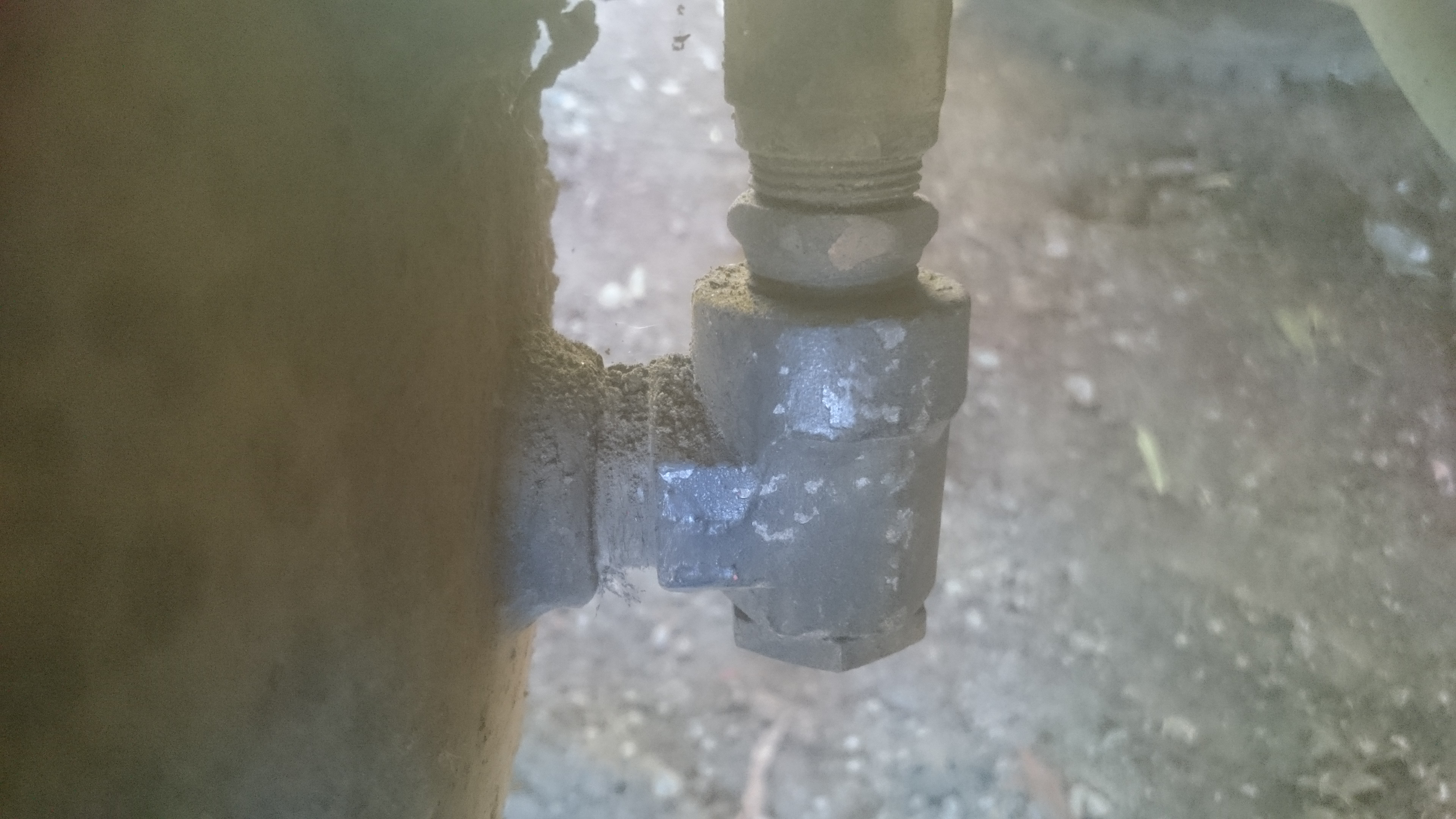

It later occurred to me that when the air lines were in situ, there would be equal pressure on either side of the check valve meaning that there would be little pressure on the rubber disk and seat so it could lose pressure from the start tank as the whole system lost pressure, whereas if the supply line was disconnected there would be 125psi pressure on the disk and seat and the check valve would be less likely to show a leak. When I replace the check valves, I will fill the tank and see if any air escapes trough the port on the start valve going to the starter which is what I suspect will be the culprit.
Unfortunately, when I tried to remove the check valves the T fitting broke off the tank. I have managed to remove the broken 1/2" fitting, but figure I will re-assemble it when I get new valves.

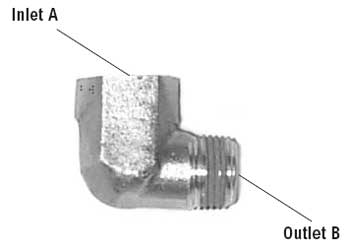

Could be Sealco?  That is what my starter tank had and was similar 90* set up.  Could not find one online looking at their website(they dont list anything 90* anymore).  Going to replace with something else.
Larry
Did some googling and found this:
https://www.anythingtruck.com/product/060-K112234.html
But it is the threaded the wrong way, unless you use a nipple on the tank and change the line fitting to female.
Larry
Thanks Freightrain,
I did come up with that myself in a search, but it would not be cost effective compared to using a straight one and an elbow by the time I had it ship to Australia.
The threading is the right way around BTW for my truck.
Aye Mate....I see your point.  :thumb:
(I didn't realize you were from down under.  The air starter wasn't a big enough clue for me :lol: )
Larry
