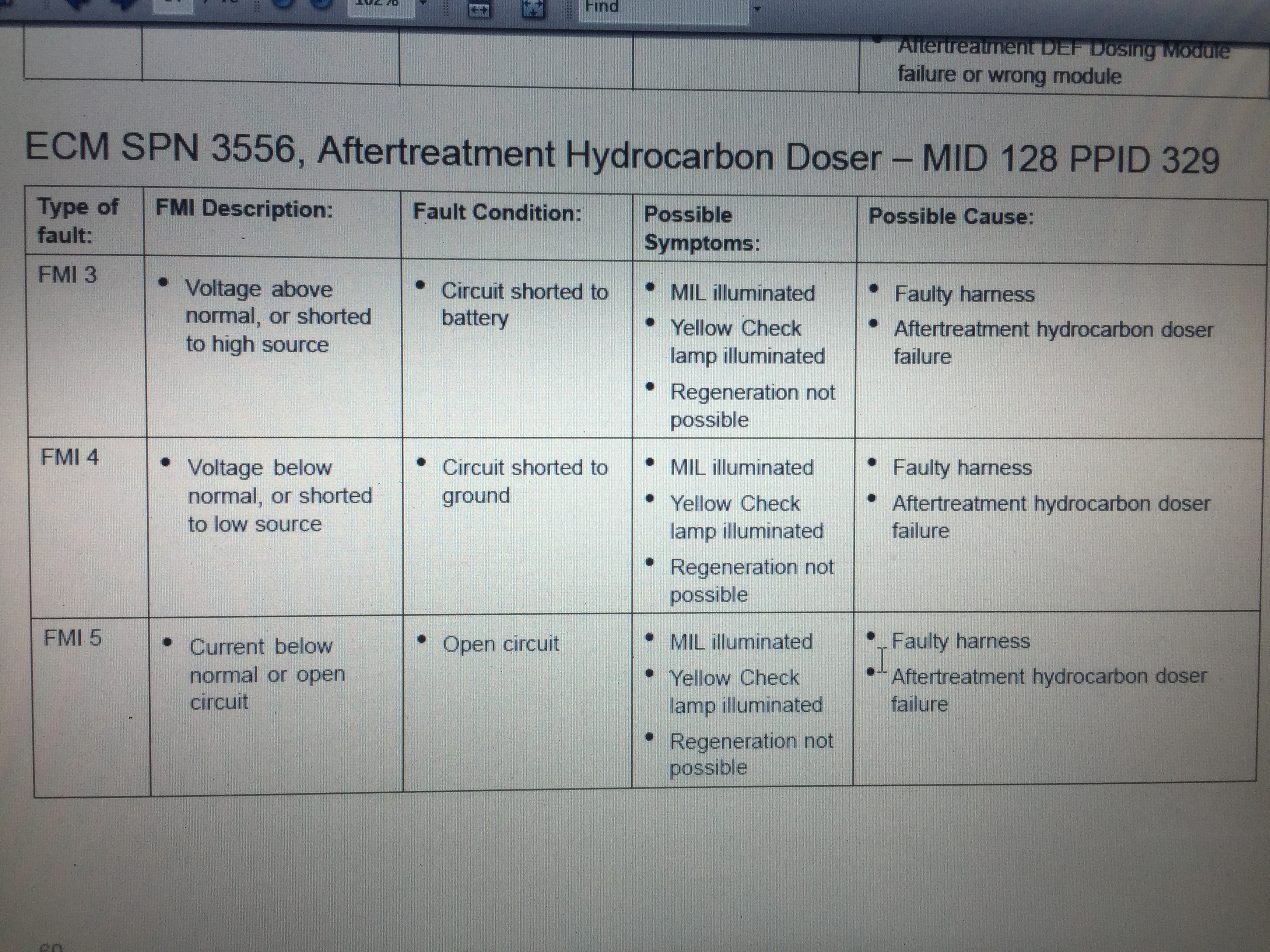

I had to replace flywheel housing and just got back on the road. 7th injector was unplugged. 7th injector fuel line was removed and re-installed. Maybe plug needs some dielectric grease? Any suggestions?

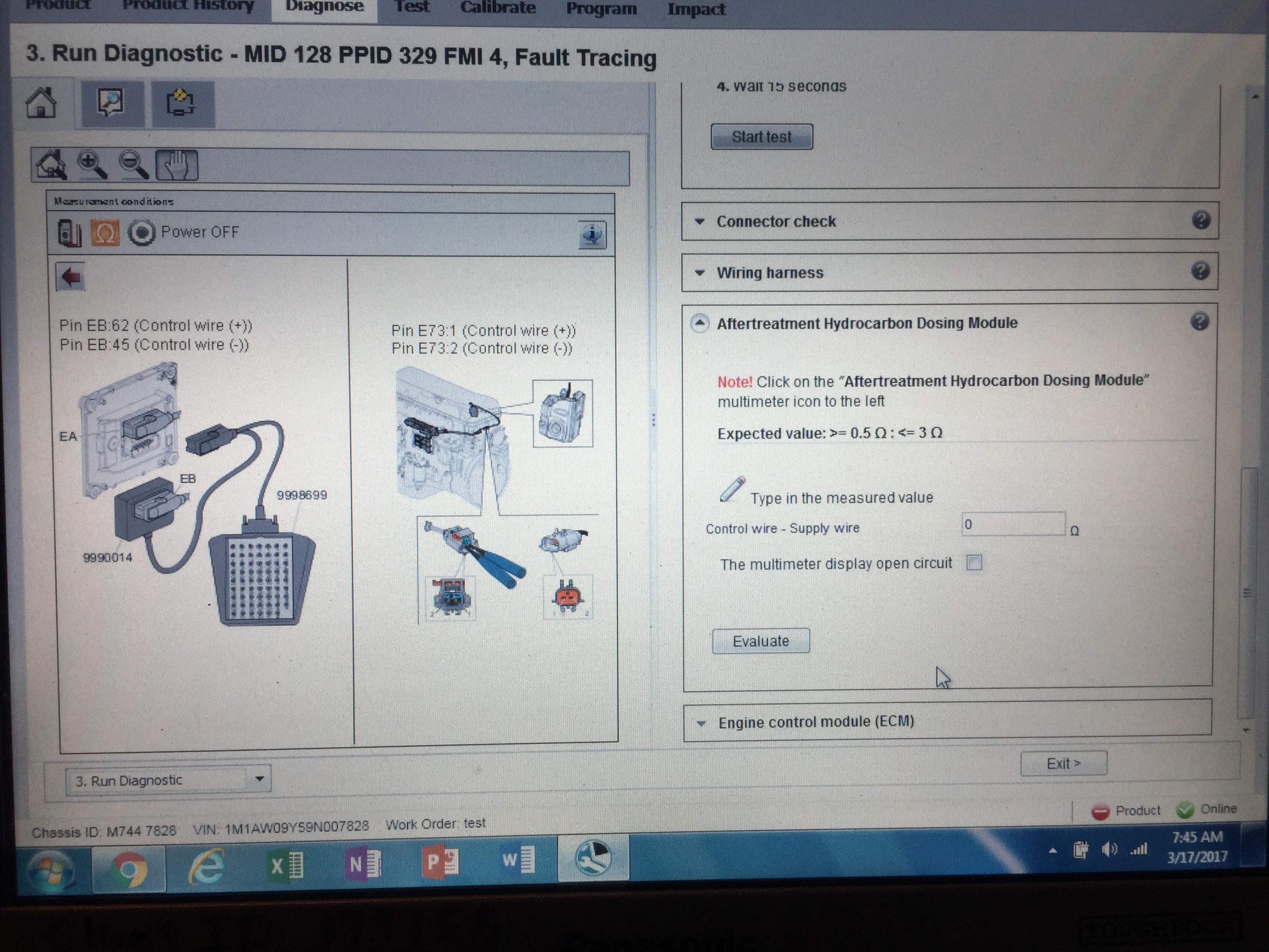

Looks like if you unplug the 7th injector you should have .5 to 3 ohms across the 2 wires  .  Same if you plug the 7th injectors in and check at the bottom plug on the engine ECM on pins 45 and 62.  There are no books on troubleshooting these anymore all in the Mack Tech Tool program now.
Yup ! Take Note !
This is an example of  WHY You pay the shop rates you do! The crap you see in the pic is the stuff The BIG V  (SELLs ) to the dealers to work on the stuff the dealer Sells  to you ( and it aint cheap ) . Got to have it to have IT to a have it to have a half good chance of repairing issues ,That unit is just one of many needed to repair these new units ( NO books) Your best chance of self repair Is Guys like Mackpro Who Care about what we are doing for our customers and like to see em succeed!
