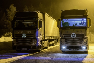

Eight Daimler test drivers participated in what would be two typical working weeks for truckers at the site in Rovaniemi, Finland.
Alternating between one week in a truck cab with conventional lighting and another week with a “Daylight+” module which supplied additional daylight while driving and during breaks, the truckers were observed and compared to only themselves.The drivers were examined for performance changes when they were exposed to additional biologically effective daylight under clearly defined conditions. The additional light was distributed in three different intensities.
  • Steady light while driving, whereby the intensity was adjusted to the exterior light level.
  • An intense light shower of maximum intensity during the tests before and after driving.
  • Light while reclined, likewise of maximum intensity, during breaks while the driver relaxes in their seat, which has been positioned for a power nap.
