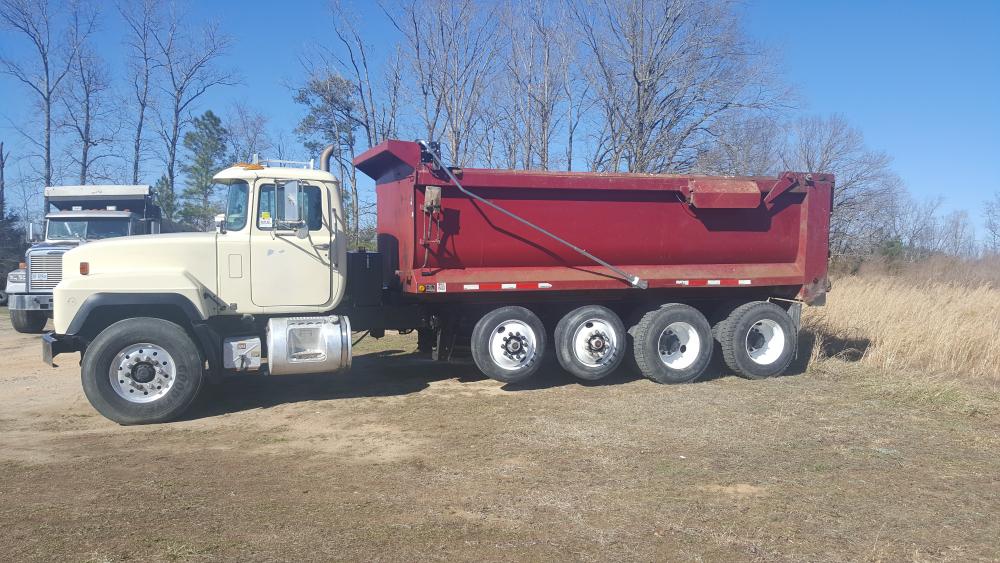

Ok guys my truck has a fuller 8ll Trans..I have adjusted the clutch in my freightliner before but the mack is a little different so I thought I would ask before I do..the clutch is releasing at the top not much free pedal..I took the cover off butthe release bearing is different from my other it looks as if it rides on the cross shaft my other truck is just the bearing this truck has a cable with a couple different points looks like to adjust other is a rod either top or bottom..so please guide me on this ..thanks in advance
