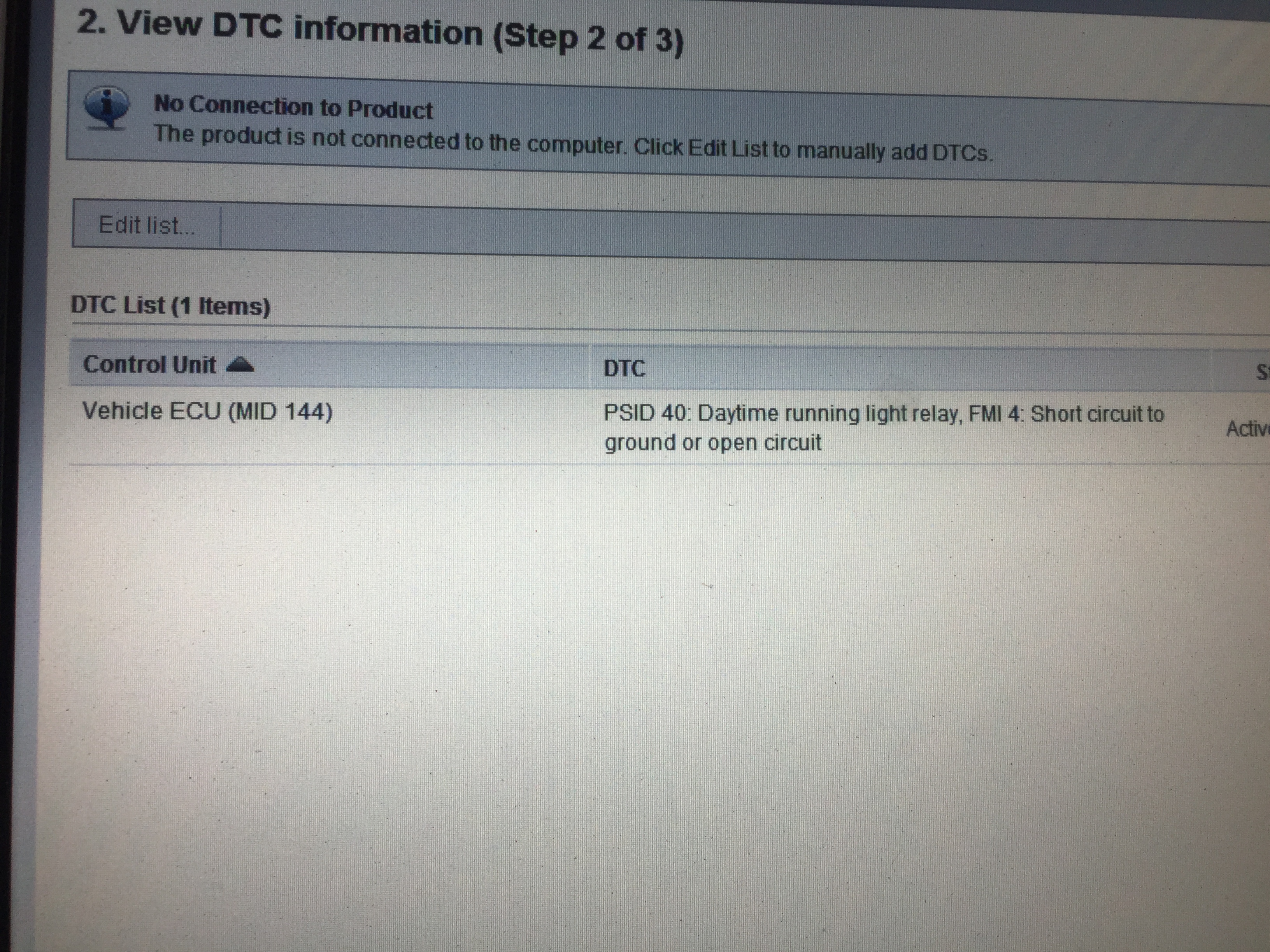

I've got MID 144, PSID 40, FMI 4. According to the Mack help line, this is saying "Sensor Power Supply is showing low voltage" so I ask my truck experts, where do I look. I think this is what makes my truck act like it has a mid fire and then smooths out after 30 miles of driving. The truck ran pretty good Friday and turns out,  that code was gone but came back again. Where should I look or what connection should I clean?
https://www.bigmacktrucks.com/topic/49488-2011-cxu-vecu-trouble-code/
Weird....i have a 2011 GU without DRL (i pulled the relay 4 years ago, got sick of replacing low beam bulbs) and its never thrown a code....
Lack of planning on your part does not constitute an emergency on my part....
LOL, Well now I feel stupid. I pulled the DRL relay because I didn't want to get pulled at scales if a light goes out. I plugged it in for a few minutes while looking for something wrong and the code was gone, I figured I did something else to "fix" the issue. As for the misfire, I guess the injectors are just old, 718,000 miles on them assuming they are original. Thanks for the help.
