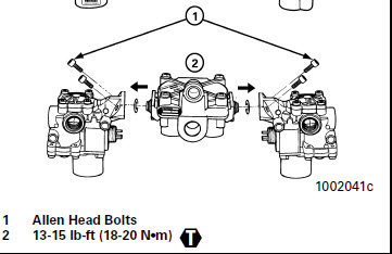

We had alot of rear brake problems on some of the last CXN's and CHN's. Something in the rear relay valve/ABS modulator valves was going bad. At the time you could buy all 3 valves assembled together and made for a easy install. All 3 were bolted together on the crossmember in front of the front drive axle like the pic shows.
