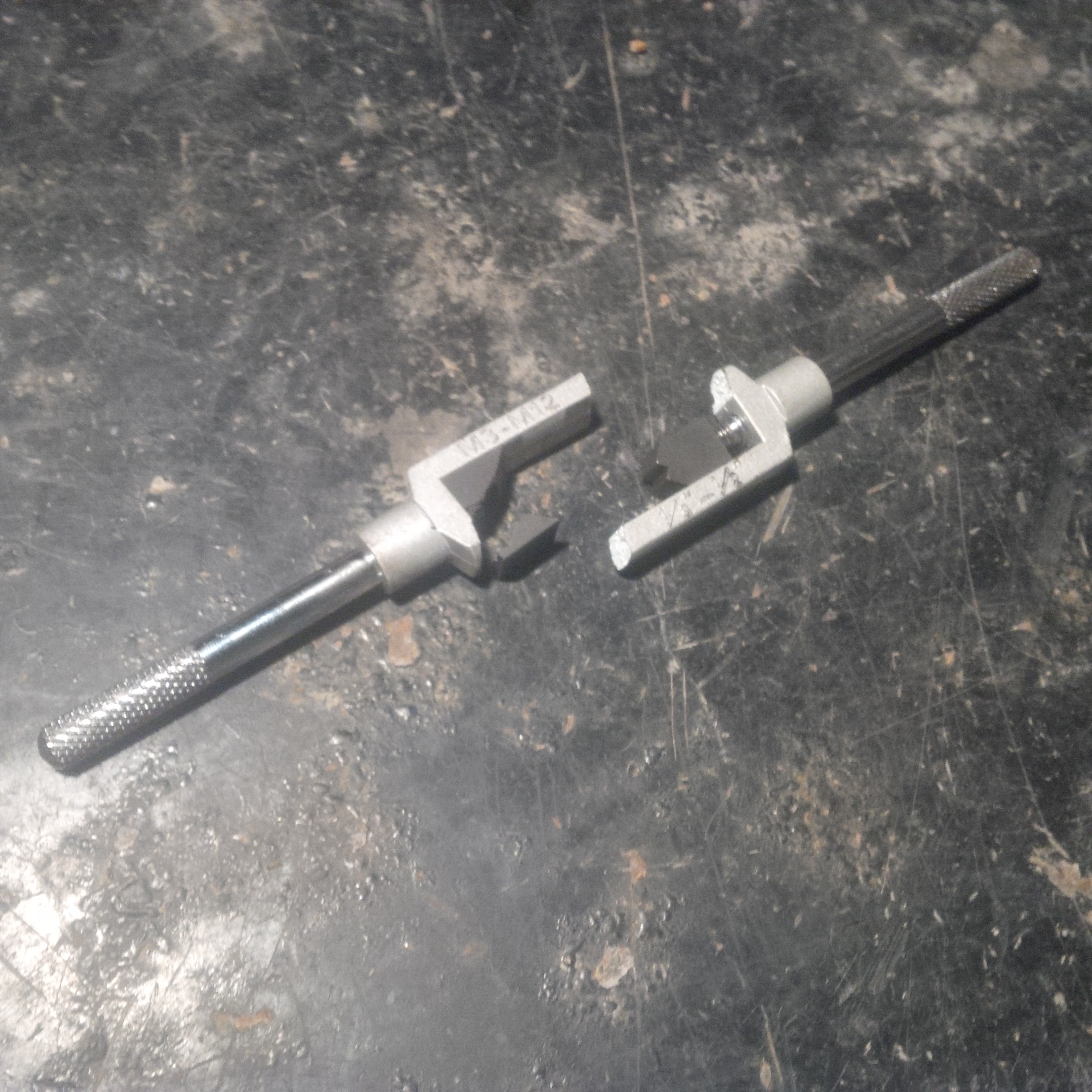

Well, for the MOST part, it was a pretty straight forward and simple job. Range control valve...4 bolts, 6 air lines, and an o-ring. Not for me. Got the air lines disconnected and started pulling the bolts...snapped one off. DOH! 1/4-20 should be simple enough...drill into it to use an easy out. Broke the damn wrench thing that holds the easy out. Plan B...drill it a little bigger and just re-tap it 1/4-20. Nope. Easy out made the hole such that the drill bit kept getting hung up. Size was close, though, so I figured perhaps I could just tap the stupid thing. Nope. Snapped the tap off in the hole. So, I cut my losses, dabbed a bit of RTV sealant on the hole, and put it back together with only 3 bolts. Got it back together, and it's holding air...so now back to repacking everything into the truck. Took a while, but I got it all to fit again. Easier to get at stuff, now, too...

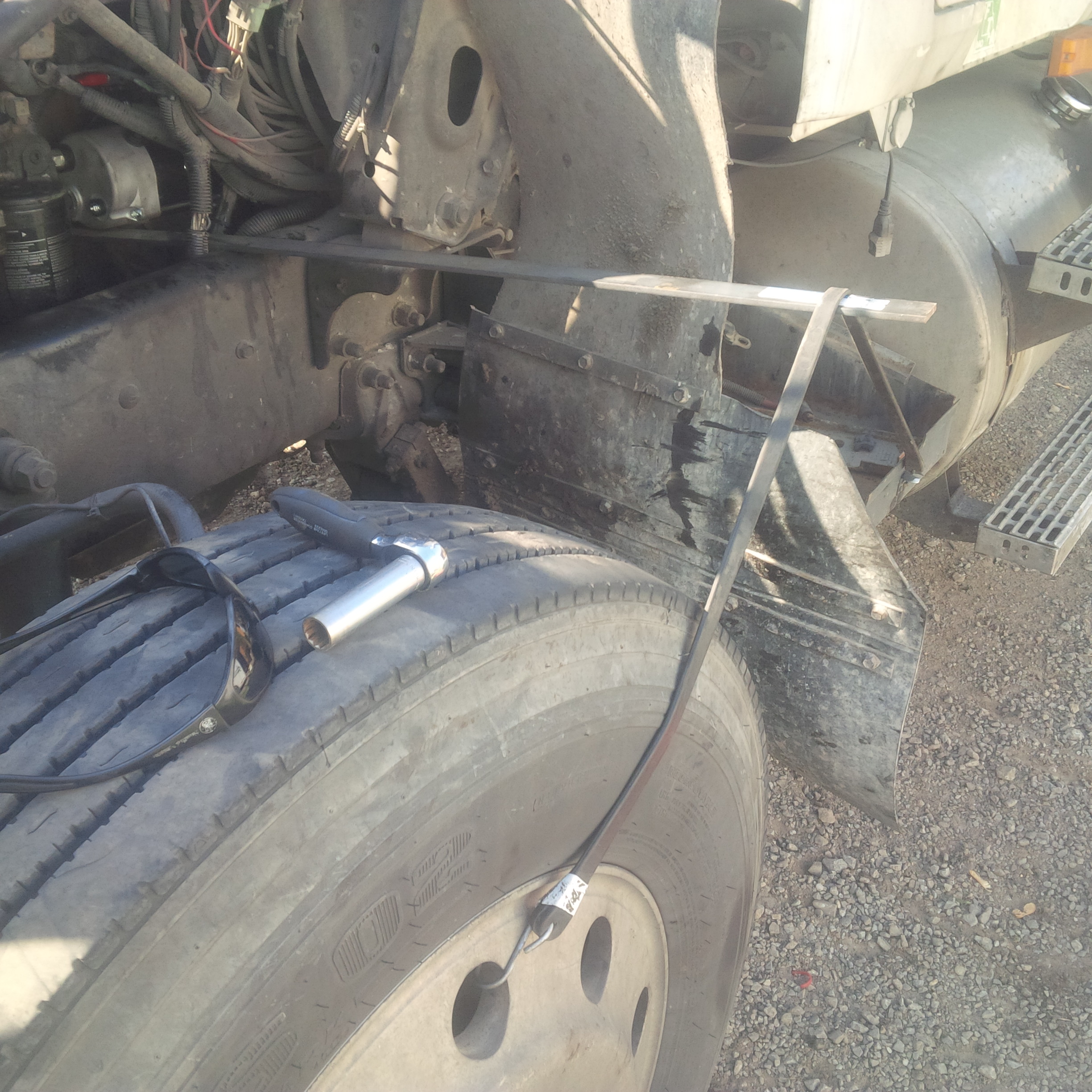

Well, after a whole bunch of cussing and carrying on in a manner likely to make a sailor blush, I came up with a solution for my lack of a 3rd hand. Redneck Engineering at its finest...

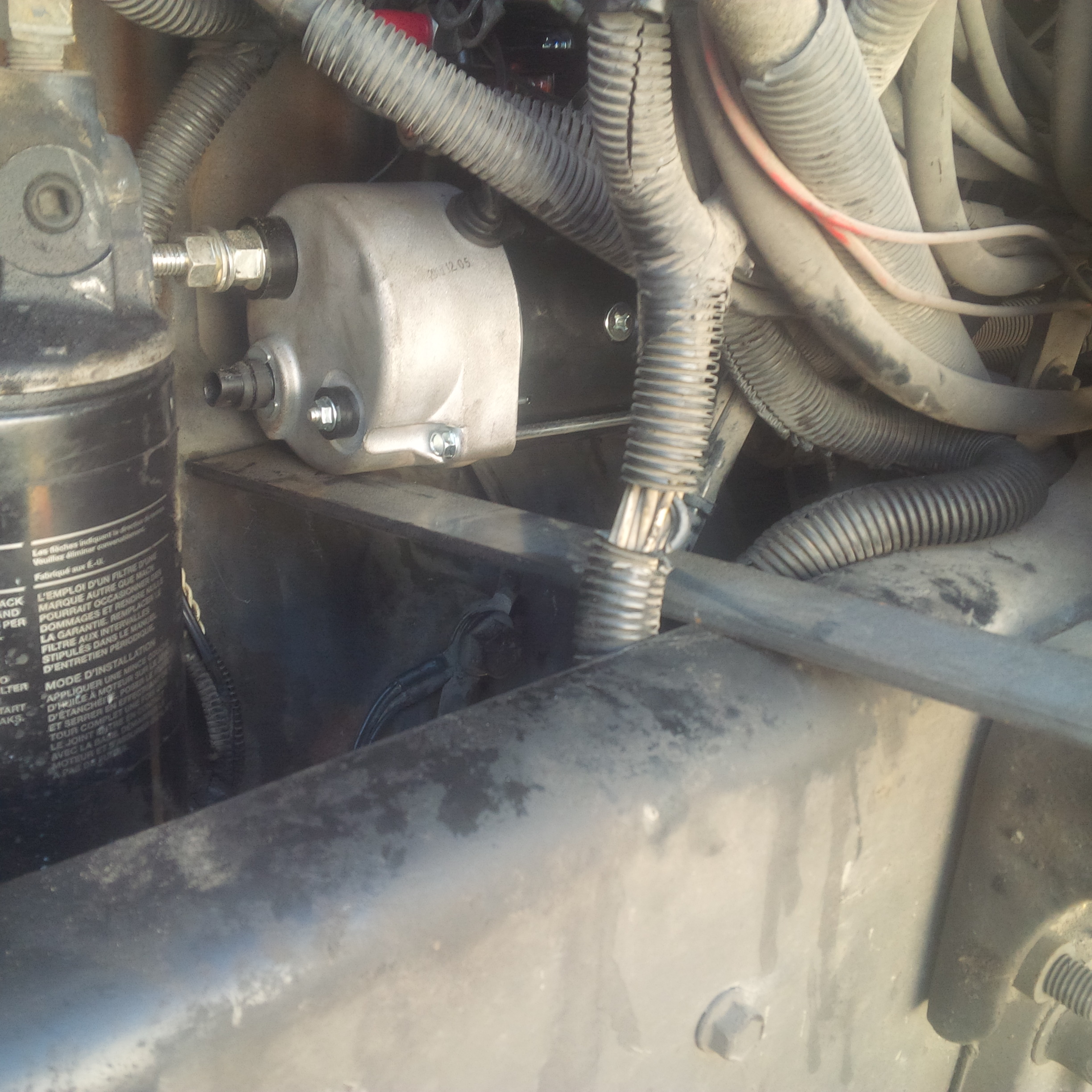

Holy CRAP!!!!! Just finished up & put the batteries back in (I'd pulled them to take them with me to town & have them tested beyond what my little 100A tester will do) and hit the key. For the entire time I've owned this thing, it's cranked slow and seemingly hard. When I hit the key, it spun about as many times in 1/2 a second as it used to in 5 and fired up LONG before I expected it to. I'm used to 6-8 seconds of cranking (unless it's hot or really cold, then longer)...and this was running in less than 1. Damn, that's nice! Hopefully that'll let me get more than a year out of a set of batteries...set I'm on now is almost at a year and a half. Exide and Bulldog brands, I'll get 6-8 months out of them. Anyway, I'm pretty happy...and since I'm already greasy, I think I'll go ahead and grease the chassis today, too. Not QUITE due, but then I can go ride horses this weekend instead of having to do a grease job on this thing.

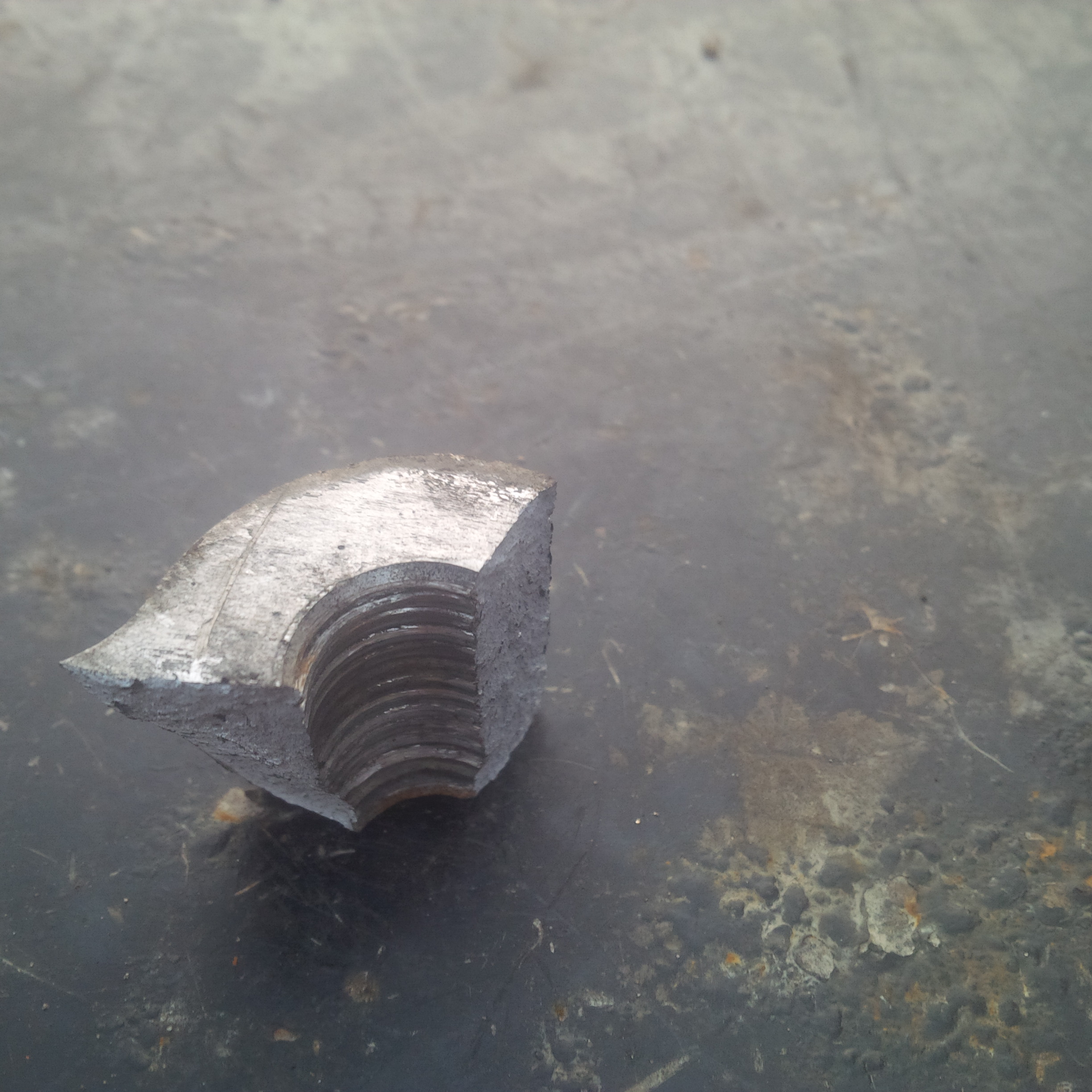

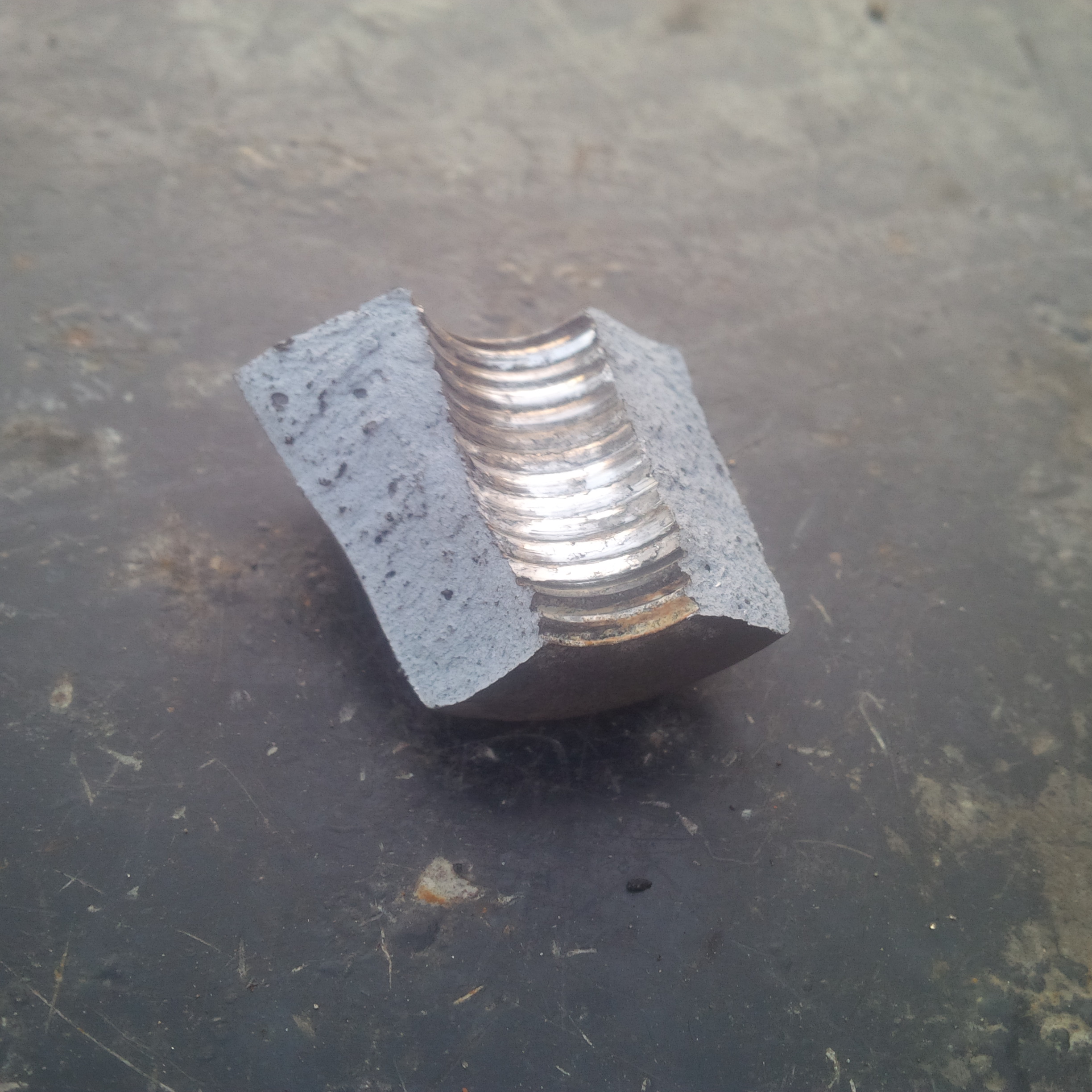

Well, done for the night. Got 'er greased & swapped out a u-joint I've been meaning to do since the last time I greased it, so it should be ready to go for at least a few more days. Starter isn't on 100%...turns out one of the bolt holes (top side away from the engine) was broke. The bolt had to have the threads cleaned up...almost like it had been cross-threaded in. About 1/4 of the hole broke off, so hopefully 2-3/4 bolts will suffice. Needless to say, I'm happy to have 'er back together so I can get back to work...but still a little PO'd that I had to do this job in the first place. Oh well...that's life, I guess.
