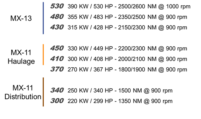

While torque peaks of both MX-11 and MX-13 engines have been increased, the big news is that the MX-13 has been boosted to a top rating of 390 kW (530 hp) and 2600 Nm of torque.
