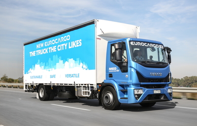

Iveco’s International Truck of the Year-winning Euro6 Eurocargo is now available in Australia, providing operators with a host of new safety and efficiency features rarely seen before in medium duty trucks.
The models come in a variety of specification choices ranging from 12 to 18t GVM in 4x2 configuration and with ‘Day’, ‘Sleeper’ (with high roof option) and ‘Crew Cab’ variants, ensuring there’ll likely be a Eurocargo to suite a broad range of applications.

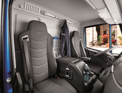

Cabin entry and egress in the new range is easy courtesy of generous steps and 90°-opening front doors. Once inside, the driver is treated to a fully adjustable ISRI seat and redesigned interior with all controls being placed initiatively within arm’s reach.
A linear dashboard design (featuring electronic anti-glare instrument panel) and the compact dimensions of the engine tunnel, allow the driver to easily move around the cabin and leave the vehicle from either side in preparation for loading and unloading their goods.
Iveco has also included a number of functional features in the cabin, allowing operators to more easily keep up with paperwork and other job requirements. The centre console has a 20 litre space (available with single passenger seat) that can comfortably accommodate a laptop, tablet and the like. It also features a reading light and is equipped with side storage pockets and two USB connectors for charging electronic devices. A practical workspace can also be created by opening out the upper area of the console.
Other cabin appointments include a driver’s side console housing two bottle holders, a 12V power socket and option for a compressed air pocket.  Additionally, there are more storage spaces throughout the cabin and a hanging rail with hooks on the rear wall of the cabin for items such as personal protection equipment and other apparel.
