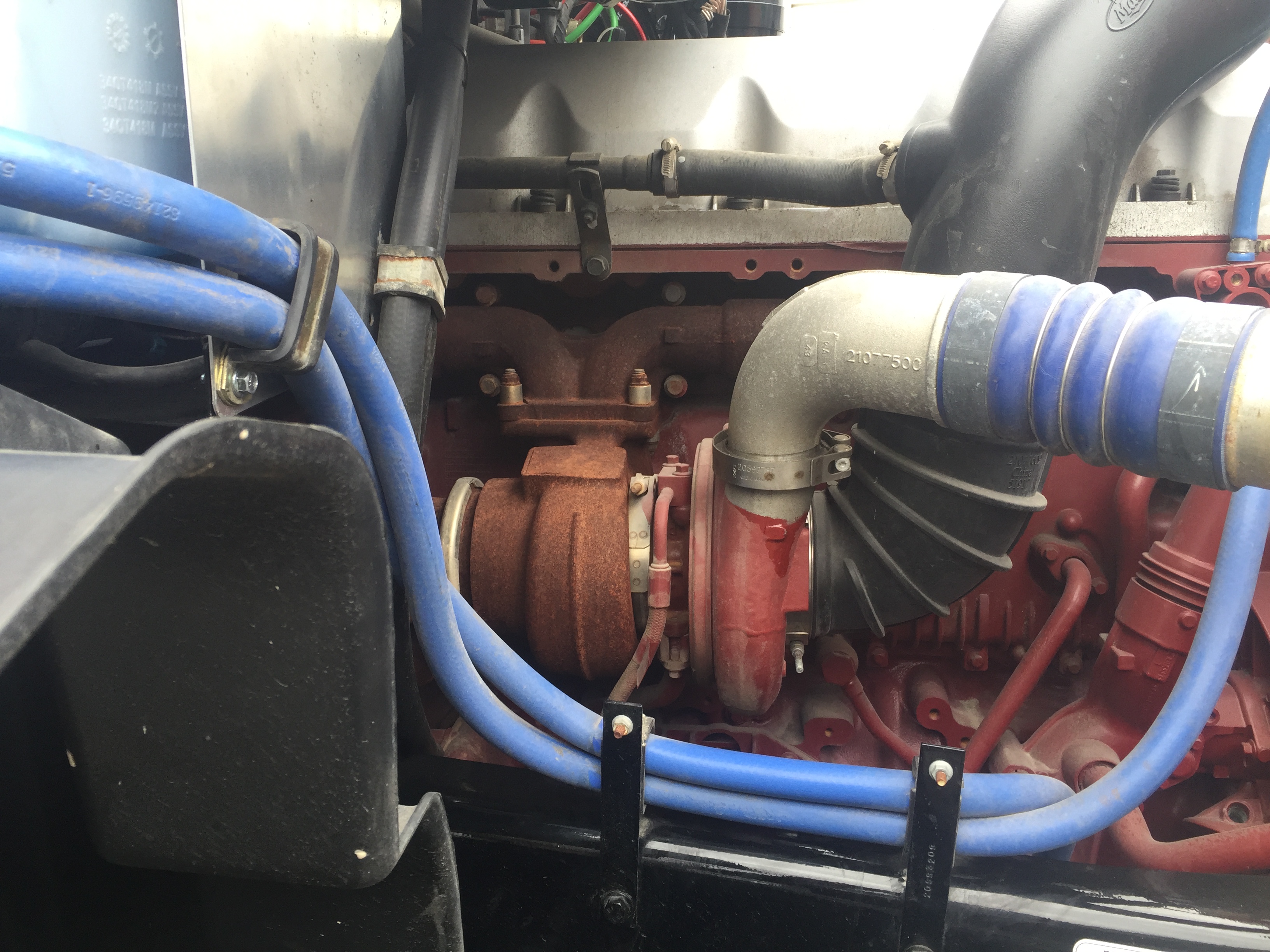

I dont know about export but in the year model 1997 you could still get manual fuel pump E-7  engines as well as the VMAC1 and 2 electronic pump engines. In the year model 1998 you could also get the manual pump E-5  engine too.  There are somehow, some export MP-8 engines running around here with no EGR, DPF or DEF
