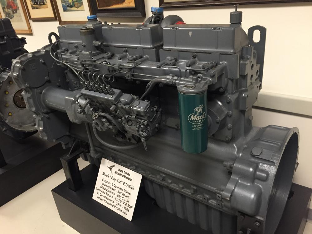

MACK developed a 14.5 liter  885 c.i. "big" six between 1978-1982 and never put it in production. Why? Most likely the lack of need or the coming EPA regulations.
image.thumb.jpeg.2f26079c7536ab313540fed2bbc99e79.jpeg.89c5f2310325223539e2959715c875fd.jpeg
