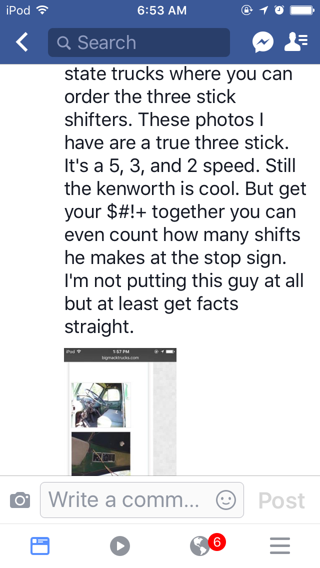

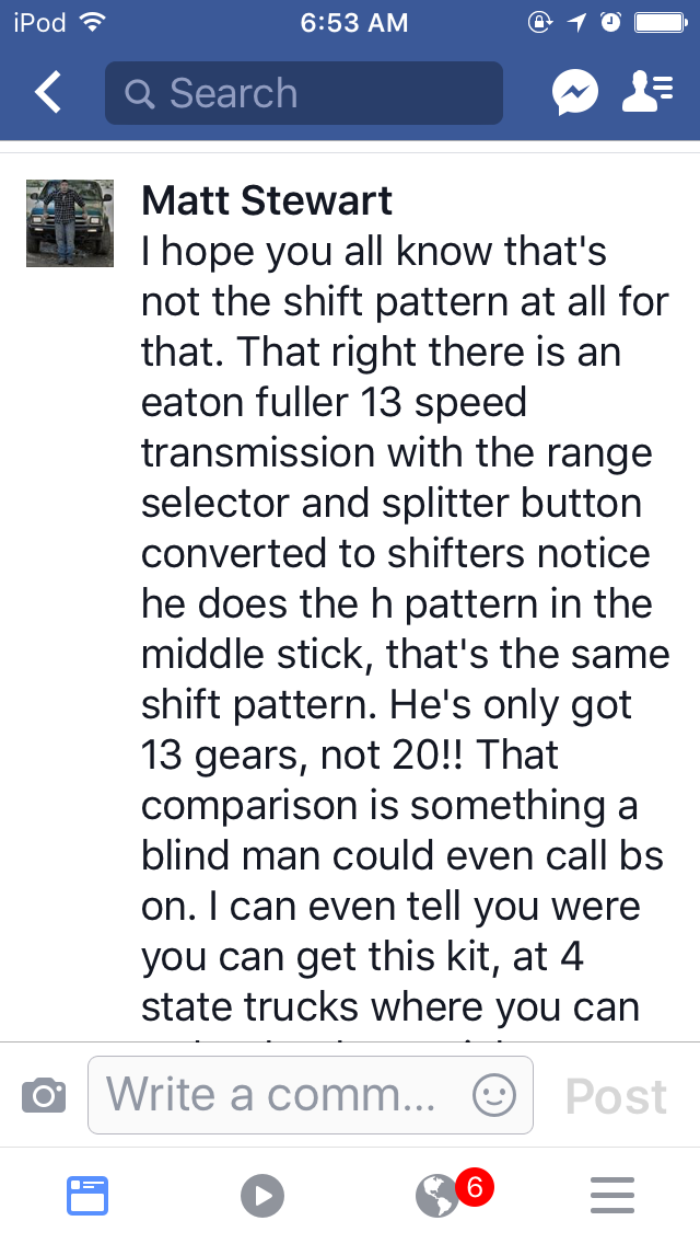

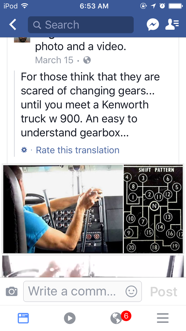

So I just joined the forum. For a long time there's one Mack truck that I've been wanting info on. A truck that a majority of people would call bs if you told them about. The three stick Mack. I first heard of it from a late friends of mines dad. Then talked about it with a guy I worked with. Even met a random guy at the fair who even told me. I've only seen two photos total of the interior with the sticks on the web and talk about on this forum on the dude with fake three stick kenworth (an eaton 13 with sticks for the splitters) I Beleve it was Mackdaddy that mentioned it. I want to know what years it came in, what model , where I could find one, and if there's a way I could  talk someone into me driving one. I would greatly appreciate info. I would like pics too.

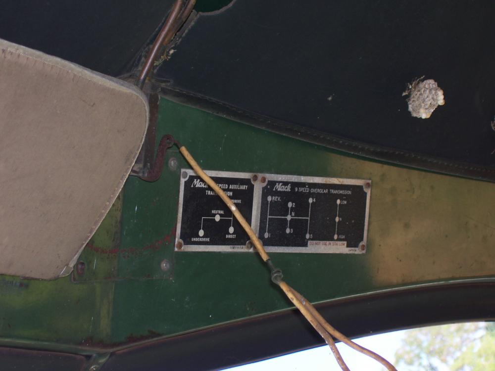

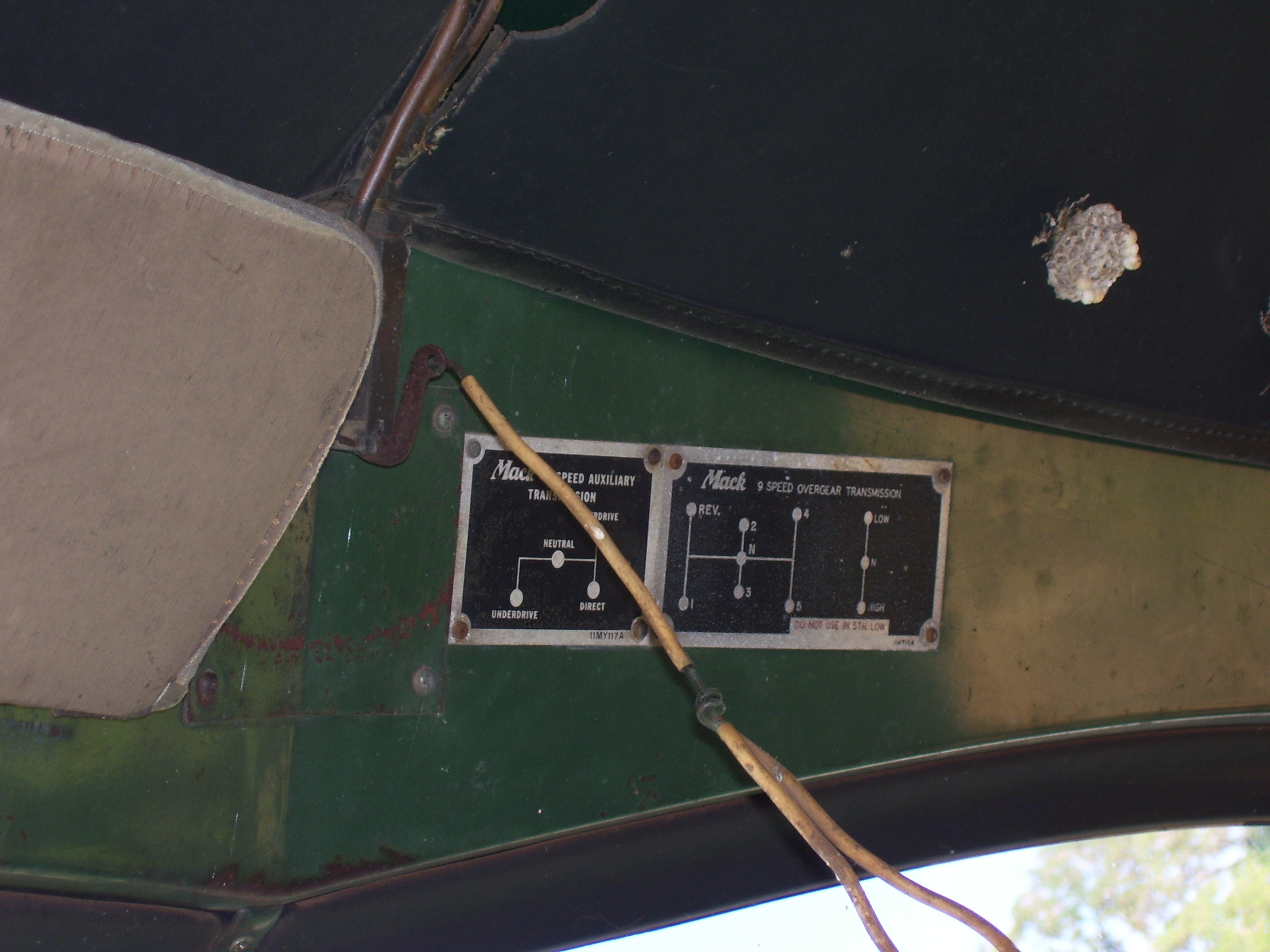

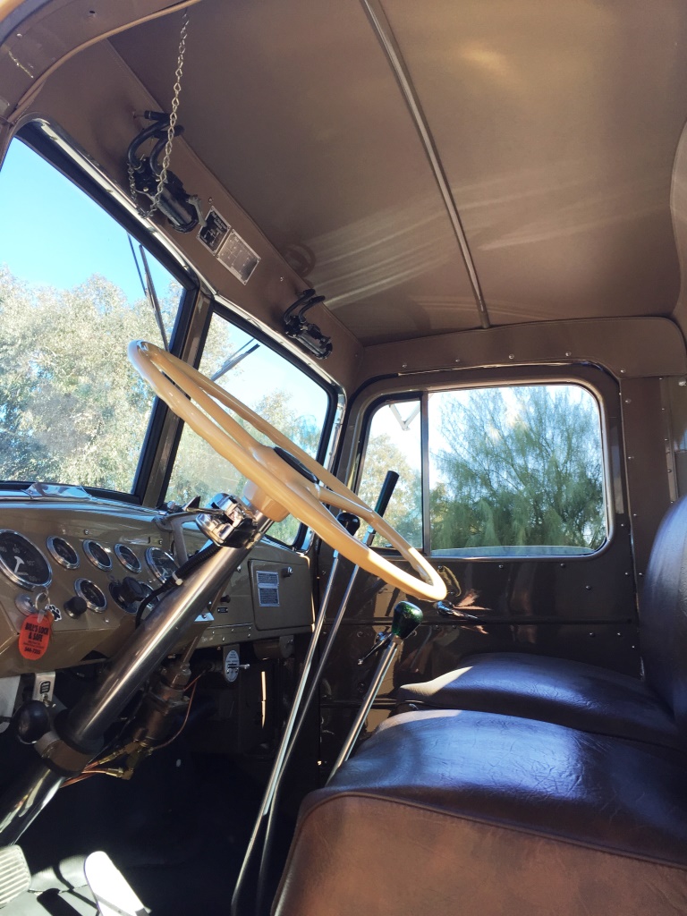

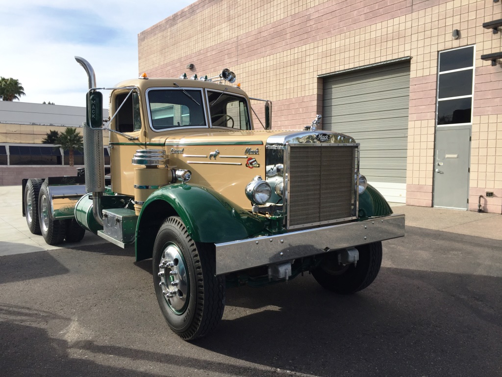

Hi there, I got a 3 stick 1953 LTL. It was that way from factory and it was not the only one built. I have seen one or two others through the years as well. Each gear is 250-300 RPM splits. the set up was used out on the West Coast. The trans set up was a Duplex and a Brownie. The way I drive it is the 9 speeds in the Duplex and then the last two shift in the 3 speed Brownie. The brownie has the second overdrive. The stick layout is Brownie stick to the left, center is the 5 speed, right is the 2 speed Duplex split. The truck does 65MPH with 5.77 rears, that was the high speed option back then. Also something that you may not have seen is the supercharged Cummins in the LTL, The total combinations are 27 forwards and 6 reverse if someone wanted to do some gear jammin!!

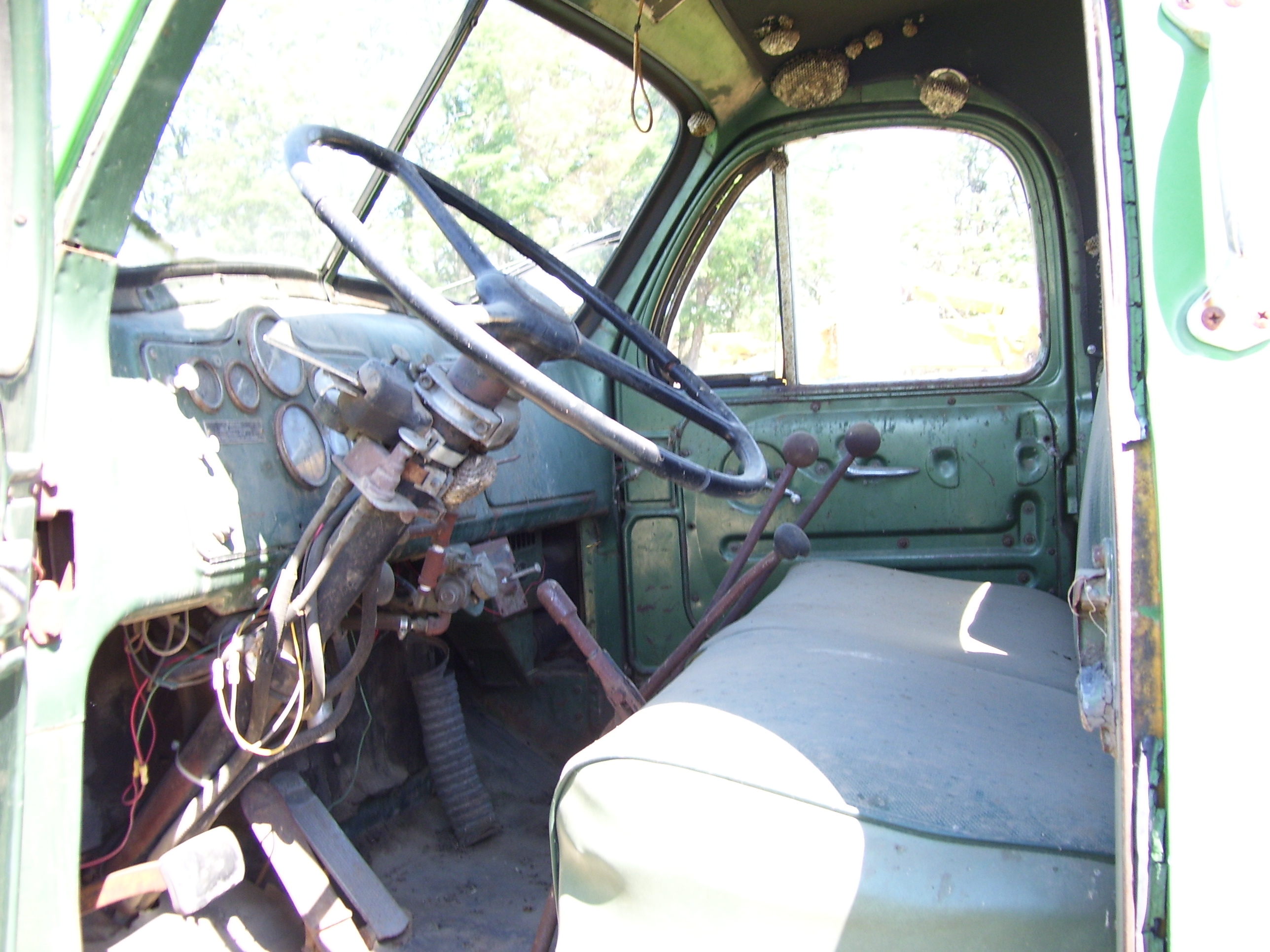

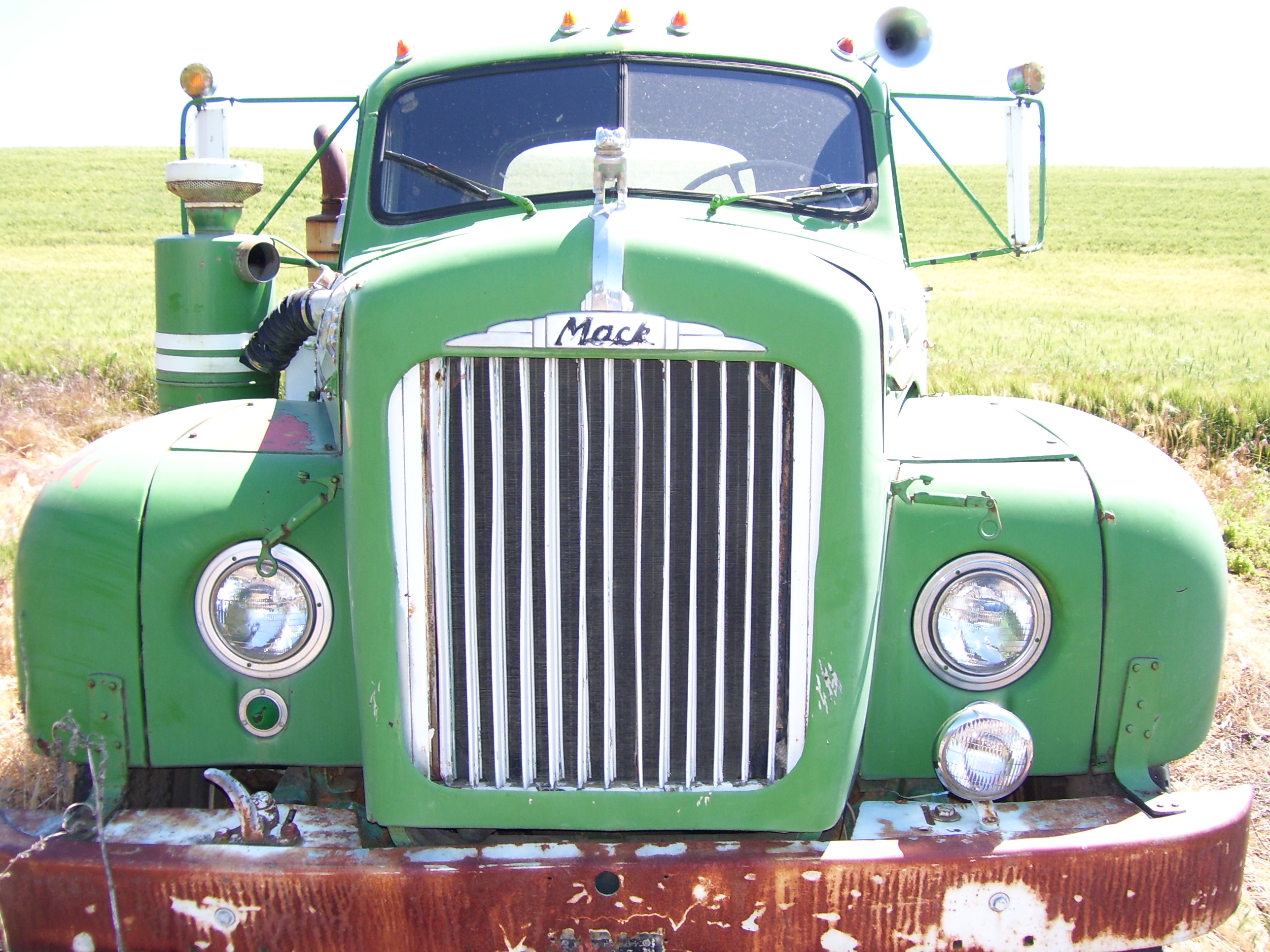

That B-71 is not mine, I have been after it for years. The guy who owns it has the idea it's a gold mine, so it is for sale. But he wants WAY To Much for it.  He is talking 25K and up depending
on your looks.
Truck Shop

It would be Great to see another B71 out at shows. I have only seen one at at the Oregon ATHS show a few years ago.
Looking at the photos it is about as original as you are going to fine and is not rusted or dented to hell. Being new to old Macks i hope you have a lot of hands on mechanical experience, aware that everything is big and heavy. and have a very large bank account to get a restoration to the finish line.
It is definitely a low production B with the Cunnings, 3 stick and has been sitting for year. It will not be going anywhere fast if the price is $25K. Before you go Mack crazy and buy it contact Dan Thomas (Mackdaddy) in Oregon he has and knows of a lot of trucks worth something in that area. His restored trucks are second to none, he may even have what you are looking for, super nice guy. I know he had a 3 stick LT with a 275 Cummins, in restoration, that he was selling awhile back.
Just a side note, It is cool to have a lot of gears but after the novelty of driving it and shifting every 10 seconds wears off you will be driving it with the Duplex ad shifting the Brownie from direct to high for the second overdrive only.  There are no synchro's in any of these trans and it takes a lot of practice to fell the gears in and not blow a shift and grind. Get two sticks in natural at the same time, pull over to a Complete STOP and start over:rolleyes:
