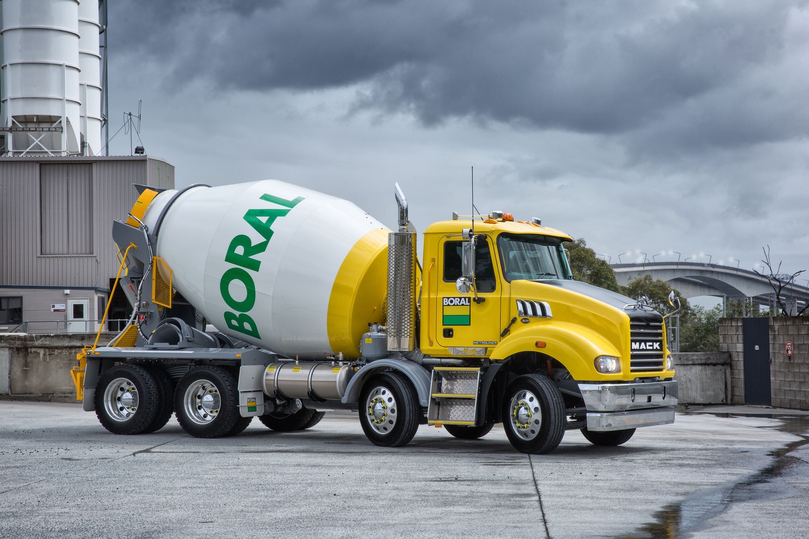

Diesel took a trip to the Boral Enfield batching plant in Sydney to try driving a low rider. It was an opportunity to have a look at and experience the difference between the traditional agitator and Boral’s new low rider–design agitator being trialled there. This plant is one of many in the Sydney area working at full capacity as a series of major infrastructure projects have increased demand for concrete in the city.

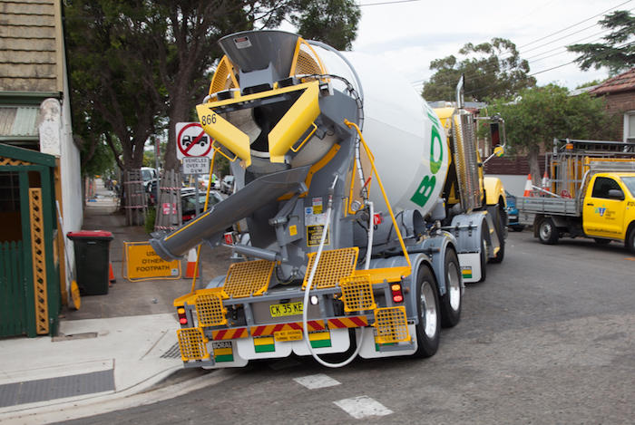

To get a handle on the improvement achieved by Boral, Diesel took two agitators out to a job. The first was the conventional agitator built in the past, and the second was using the new design. Apart from the new layout every other aspect of the truck was the same.
Anyone who has steered an agitator at all will reaffirm the inherent instability of the platform. It’s a bit like being on roller skates, you have the feeling one false move and you will fall over. This makes the driver keep well within the parameters of safety, especially on roundabouts and other sharp turns.
Jumping into the truck for the second delivery was a complete contrast. The truck felt just like any other, it could have been a fully loaded tipper or box truck. Even in a straight line the improved stability is obvious. When it comes to corners and roundabouts the driver feels in full control.
At the same time there is great feedback from the truck. The seat of the pants feeling tells you just how the rear end is reacting. The result is a much more secure feeling at the wheel. You are no longer riding on roller skates, but a normal stable truck.
