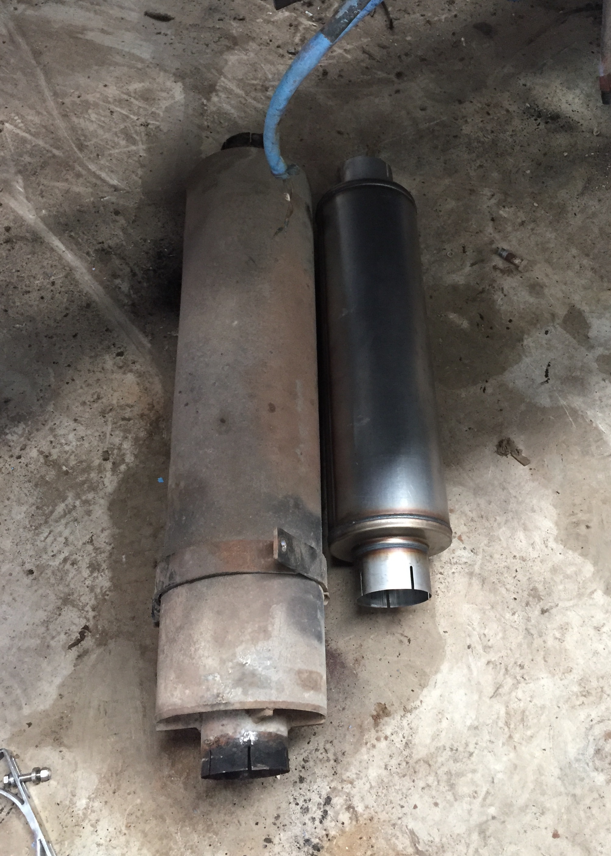

I picked up a new muffler off eBay for less then $100 shipped to Aus. Nice stainless job, they claim it's made in the USA.
Thats it next to my original one. Hope it sounds good. IMG_3054.thumb.JPG.a1c696eaedb3fcdb6885d842115fe303.JPG

On 01.06.2017 at 3:32 PM, Timmyb said:
Thanks for your replies. I'll definitely try and clean and sand as best I can.
Sorry and maybe I'm wrong, but it doesn't look like stainless.
https://www.bigmacktrucks.com/topic/49994-exhaust-coating/#findComment-373859
13 hours ago, Timmyb said:
I'm of the belief it's a lower grade stainless steel. I've had grade 304 on car exhausts before it it's super shiny like chrome almost. Then I've had other car stainless car exhausts and looked nothing like stainless.
Probably 301 Stainless, good weldability. Better wear resistance and fatigue strength than 304 in exhaust products.
