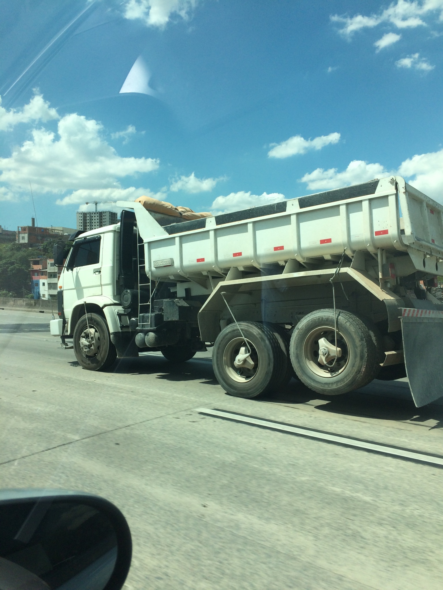

How about this crazy set-up?
Tire inflation set up. The Scannia you looked at had the same thing.
https://www.bigmacktrucks.com/topic/50046-what-in-the-world/#findComment-371337
Yeah, there on 85% of the trucks there. Roads are pretty rough of the main highways.
https://www.bigmacktrucks.com/topic/50046-what-in-the-world/#findComment-371338
The M917 dump I'm looking at has the U.S. DOD spec set up on it. I thing it's a good thing.
