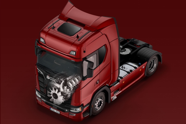

While the 16.4-litre cylinder block remains the same, the complete engine weighs approximately 80 kilograms less than its predecessor. This is mainly due to a simplified engine layout with fewer parts overall – for example, the exhaust gas recirculation unit has now been removed. Consequently, the new V8 trucks have a higher load-carrying capacity.

The turbo unit also helps reduce the overall weight of the engine. This is because the exhaust manifolds meet in the turbine housing from both sides instead of meeting in the turbo manifold, as they did in the previous generation, which was a more expensive and heavy solution.
With the introduction of a single bank exhaust gas manifold, the overall weight of the engine has been reduced, while at the same time the legendary V8 sound has been improved.
