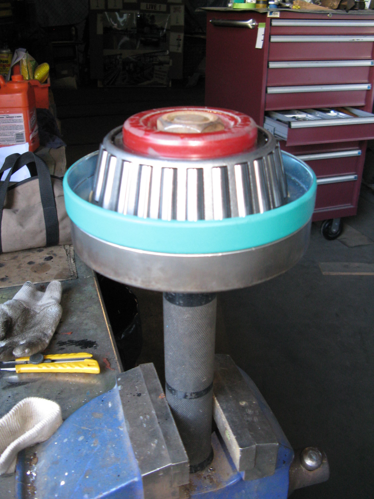

as terry says... try a heel bar, be careful if you use a steel punch which can damage, 2x4 or big dowel would work too...
if you can find an installation tool that would make life easier
don't forget to pack the bearing with a bit of grease, they need that until the lube oil eventually gets there, you can tilt the axle to help flow or drive opposite wheel up on a mound, then recheck diff level.

Yes the linings look to be soaked I read up on some remedies. One being brake clean and a propane torch. But someone loaned me the appropriate tool and came out pretty easy. Got a good part number so next week it can go back together. Is there a torque spec for the large spindle nuts and axle shaft bolts?

Did you get torqued up right?  Supposed to be 200 to seat the seal and bearing then back off full turn torque to 50 ft lbs while turning the wheel then back off 1/4 turn and check slop. .001 to .005 then lock washer then outer nut to 300 to 400 ft pounds for dowel style or 200 to 275 for tang style
