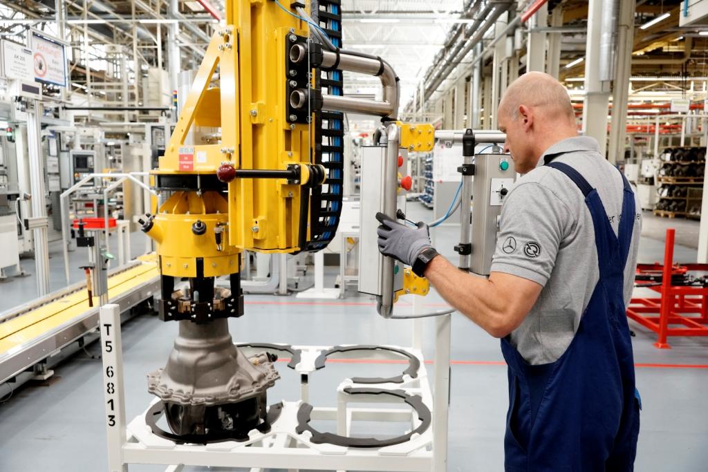

On 13 June 2017 the Mercedes‑Benz plant in Kassel had two reasons to celebrate: the start of series production of the fuel-efficient truck axle and the inauguration of the ultra-modern assembly line that was constructed at the site in recent months. The plant boasts cutting-edge production technologies and a high level of automation. For example, components inside the axle can now be directly welded together with new laser technology instead of being bolted. The resulting smooth mating surfaces reduce unnecessary oil swirl in the final drive and have a positive effect on fuel consumption. A total sum of around 30 million euros has been invested in the new NFD assembly line in Kassel.
