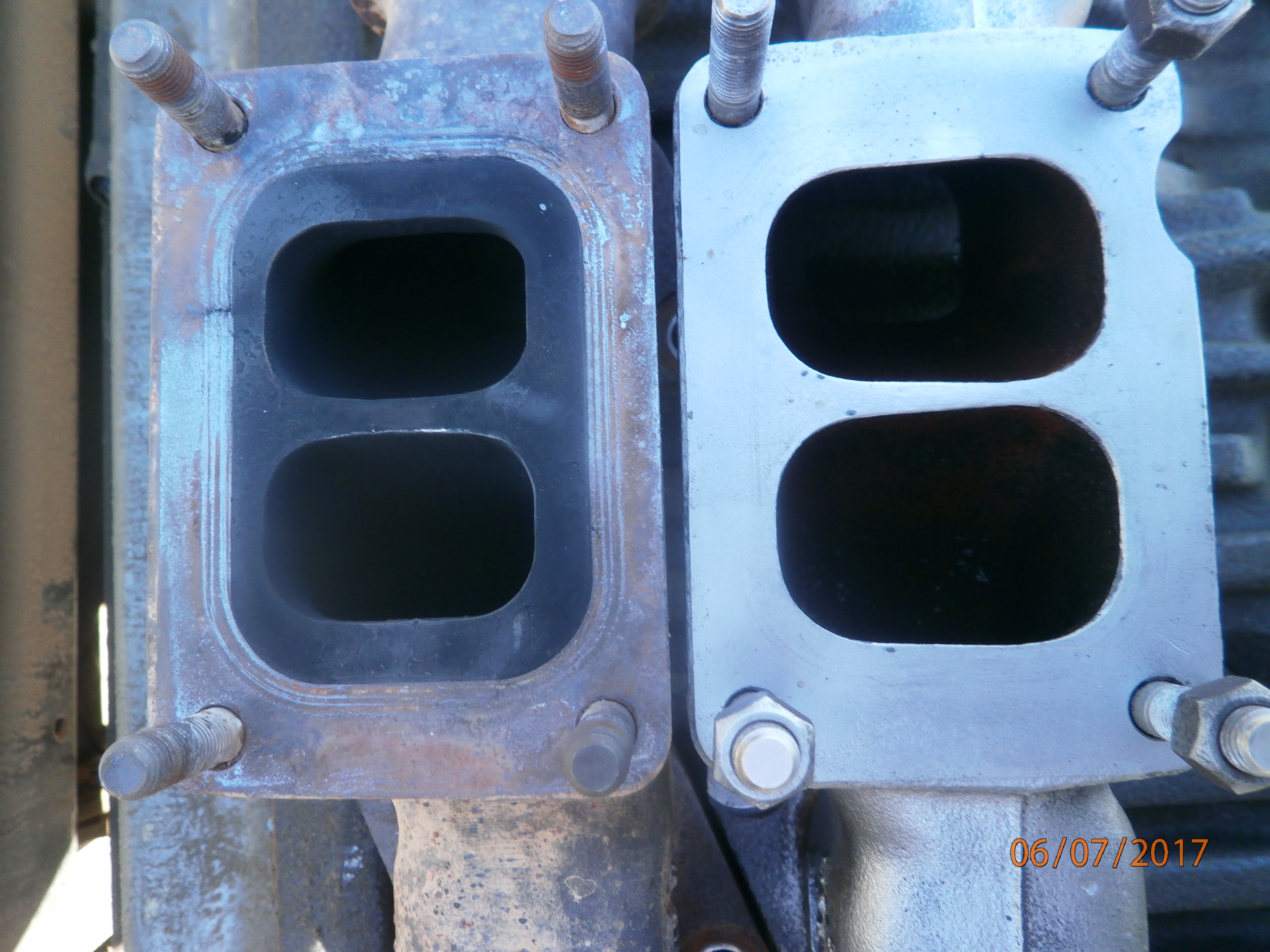

Mine was 2002 CH613. My old cohorts at the Truck Center said they grabbed manifolds all the way back to PLN..... Just watch out for CL chassis with E7 manifold which tilts upward.
Expand
Is there a specific part number for this manifold?
  On 6/22/2017 at 5:02 PM, Mack Technician said:
AI restrictor left                                                                                                E7-Etech right
Mounting height/depth/angle/position of turbo is perfectly matched, no adjustments needed.
594bf81a8a674_41manifoldcomparisonAIVs_Pre.thumb.jpg.37b5e77d22c043d24a0d092dfe9457e2.jpg
Expand
