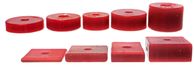

Can you post a photo and mabe some dimensions? Might be able to match up the equivalent through Energy Suspension in poly urethane and metal.   Paul

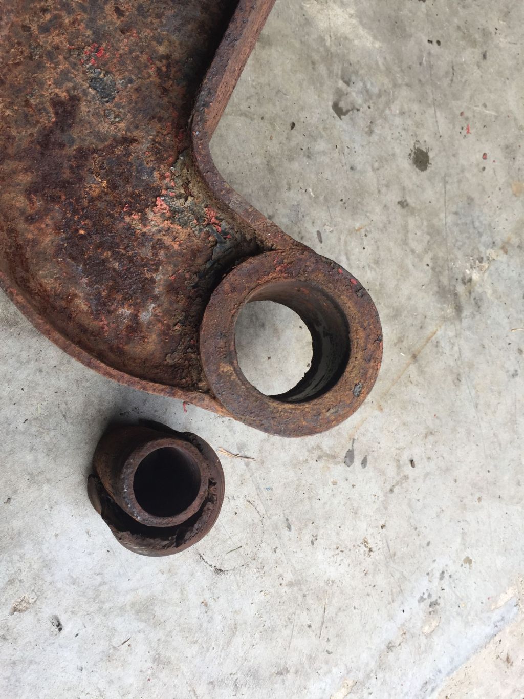

The bushings are 1.125" id, 2.125" od, 2.375" wide. In the photo, you can see the rubber has worn away on one side. If anybody has any suggestions for a source, I'd appreciate it!

Looks like the bushing outer sleeve is still in the bracket.  The I.D. is what makes it hard to transfer to a suspension piece, but poly body mount bushings would work as a start to have machined to you I.D and O.D. to reuse your steel sleeve. Poly or Nylatron can be machined easily on a lathe
Try a 4x4 shop near you for Dodge Ram Body mount bushings in Poly or Nylatron.
Yes, I measured outside the piece that's still in the bracket. Thank you for the suggestion--I'll try that.
