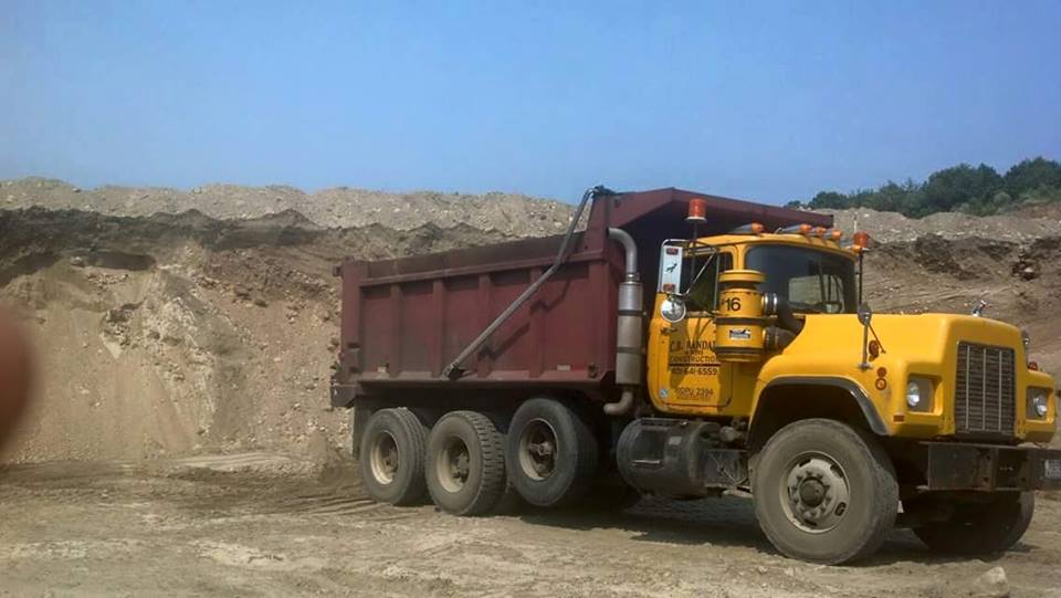

I put a Bibeau BMT on my 87 in 2004 and there are no dents in sides and none in floor. The top layer of the floor is getting thin about the last 3 foot of it. I work as a for hire truck and haul everything from concrete slabs and foundations, broken asphalt, ledge, and processed materials.
