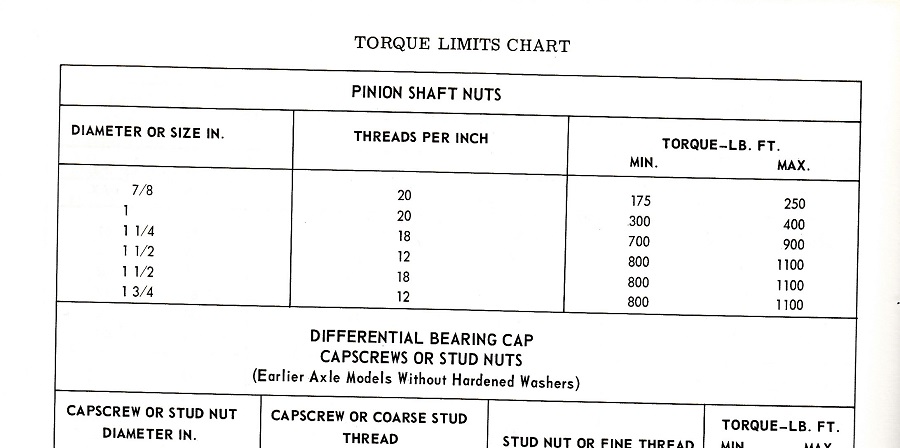

Good evening, I am going to be putting a new pinion seal in my 91 Superliner triaxle with Mack 44's and was wondering if anyone knew the correct torque? I asked the guy at the parts counter when I picked it up and he told me they have no specs for anything pre 2000. Thank you!
https://www.bigmacktrucks.com/topic/50384-pinion-seal-torque-specs/
Thank you very much!! Yes, we have unfortunately had very little help from the dealer on a couple projects. We were hoping to find some books at Macungie but came up empty handed. Luckily we have this site or I don't know what I would do. Thank you again!!
If you check evil bay there's plenty of repair manuals for CRD92/93 carriers which should be installed on your Superliner if the axles are Mack.
