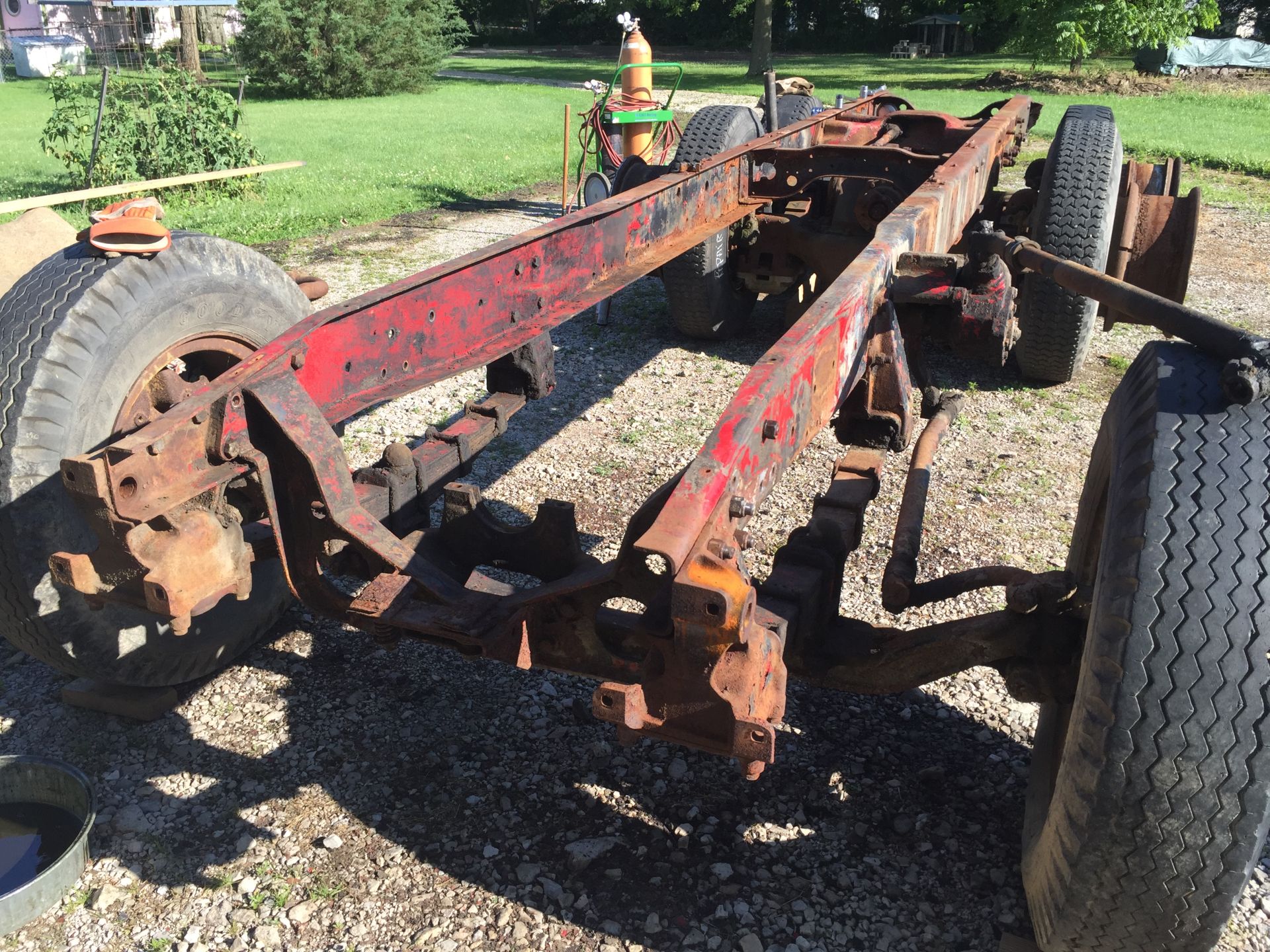

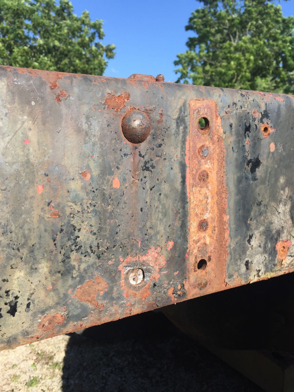

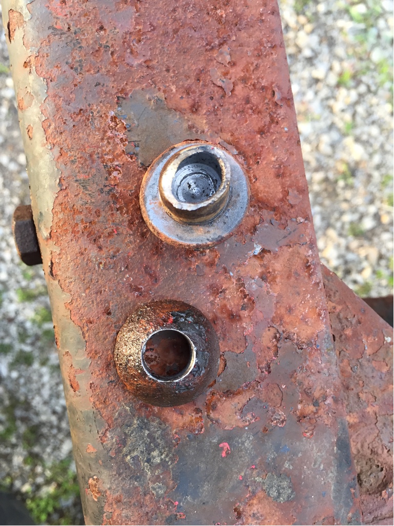

Well, I got some more brackets and such removed and I found some heavy rust on the frame rails. They will probably suffice since this will just be a hobby truck, but I'd  really like to replace them...does anybody know where I can get new or good used rails for an H67 tandem? I don't want to splice them. Second question: how do you remove the buck rivets in the crossmembers? I cut the head off one but the shank is swelled in the hole so it won't drive out.

When  removing lots  rivets grind off the head on one side  drill 3/16 hole 3/4 of the way through the rivet then go back and drill them out to 5/16 use a 1/4 inch punch this will let the rivet  collapse to the inside  with larger rivets go with a larger hole till you find what works

I may do that; it's not the appearance I'm worried about. The rust is really deep, like half way or more through the metal. In some spots it's right in the radius of the flange which is a bad spot for cracking.

I have drilled straight thru the center of the rivet after you grind the head off. drillin a 1/4 hole thru the center sometimes relieves the pressure then heat around the outside with a torch to expand and get a BFH out

Heat is your friend... lots and lots of heat. Hot and cool cycling the rivet will breakdown the rust - air cooling between cherry red is fine. And a hammer... a BFH (big f...ing hammer) and punch.

I am not too wild about using heat on the frame, as it is heat treated.  Same reason you should not weld on them.  I have a 1918 truck frame we took apart last year to replace a frame rail, rivets and all.  We cut the heads off one side with a cutting wheel in an air powered tool first.  We then took an air rivet tool with a punch in it, and pushed them out.  It wasn't easy, and it was loud!  A few that seemed stuck we drilled out the center of the rivet as described above, then used the air hammer on them and they came out. After that, I cobbled up a 70 ton hydraulic tool to push the rest out, using an old punch and die (we are a steel fab shop).  Like I said, I am not fond of heat for this application.  We did use heat to put new rivets (5/8" diameter) back in when we put it back together. We heated the rivets up to cherry red, put them in the hole, and banged away on the other end, just like they were put in originally. Just my 2 cents worth.

I sort of agree with no-heat - if it's a new truck. But when the whole project is considered I suggest that 50 years of rust, load-stresses, vibrations, accidents, unknown repairs and methods of repair, frame straightening with big hammers (thinning the material), lots of heat and a lot of bending force... will have a bigger impact on the material strength than localized heating of the rivet & area. Unless there is documentation, it's really hard to determine if something is heat treated or it's simply a high-strength material.
Auto companies use high-strength steel and anticipate accidents and damage repair, so they make accommodations with welding guidelines. Mack Body Builder instructions also show proper welding and modifications to the frame/chassis.
With repairs and restorations and with unknown history, everything thing is a comprise. Seldom is an old vehicle "correct" and unmolested.

I decided to try the drill method; I was surprised at how easy the rivets drill. I started with a 1/8" and stepped up to a 1/2" bit, I kept the drill slow and lots of oil--it went fairly quickly. Chiseled the head off and the body popped right out.

The rivets are made of low-carbon soft steel. To be shaped up by pressure. That's why you (and me either) drill them easyly.
When re-riviting my frame I ordered making new rivets in a machine shop. Had to buy a stock of sutable steel for, being guided by general recomendations on that matter.
