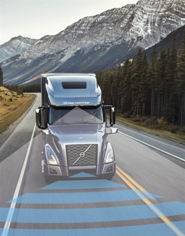

The system relies on data from a front bumper-mounted radar sensor and a windshield-mounted camera and offers a series of visual and audible alerts depending on the forward distance of the front object. Cruise control does not have to be engaged for the Volvo Active Driver Assist system to work.
With a detection range of 22 degrees wide and 500 feet in front of the truck, the radar systems can detect the angle, speed, and distance of an object ahead. A camera with a viewing angle greater than 42 degrees complements the radar and can determine the size and lane position, as well as other characteristics of an object.
