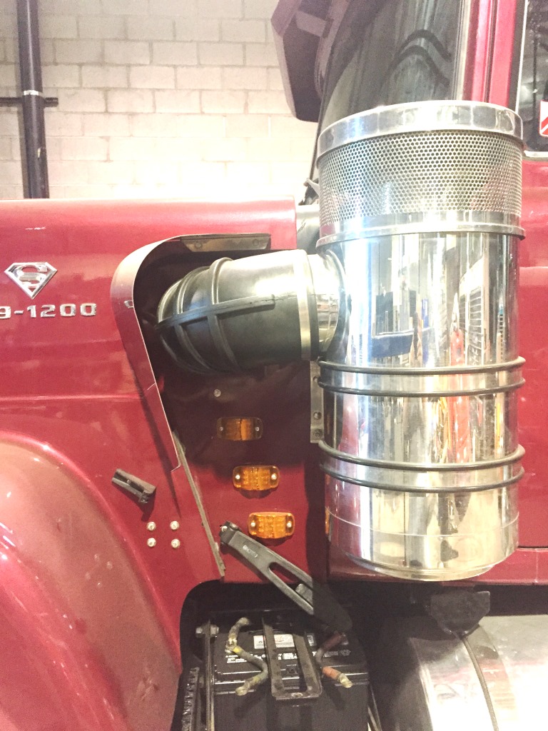

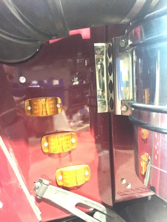

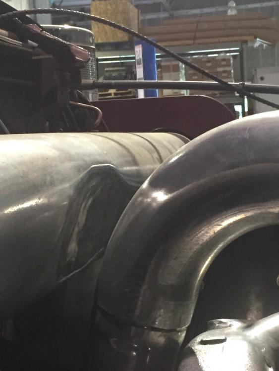

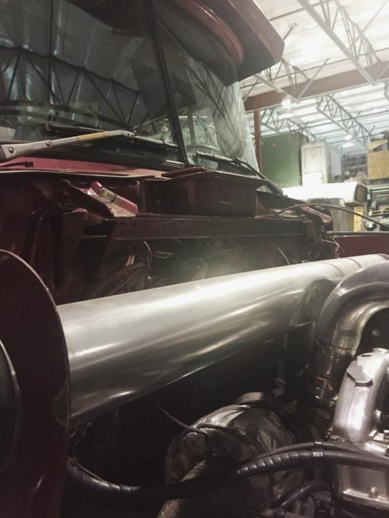

The thing you have to look out for is the clutch cable. The one on my truck is high were as "back in black's" cable is under the crossover tube if I recall. I could have the crossover tube up an inch or two and would help with a clearance problem with my turbo tube. I needed to recess the tube a bit to clear as in the photo. The cut-outs in the hood comes up to the molded fiberglass support then reinforced with a piece of 1/8 stainless plate. The side support/cover the intake runs though are made of 1/8 aluminum plate and bolted to the cowl edge and have a band-iron enforcement behind. the lights look good at night. These are 13 inch Vortex stainless cleaners which look good and work great. No real clearance issues with ether door. The side vents will be inoperable and behind the cleaner mounts. You have to extend the lower cab pins and hood mounts forward.

Filler panels where fabed, the KW cleaners work fine, but not the mounts! Can't open the door with the Kw ones, got new mack bands to mount mine, moves them far enough forward to get door open . from there I used KW tubes and a couple odds and ends to angle around clutch cable and connect to turbo, keep in mind this KW donor had a Cat and that was what I put in my Dog.

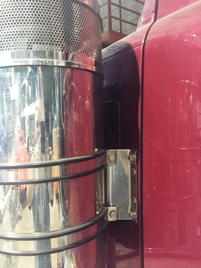

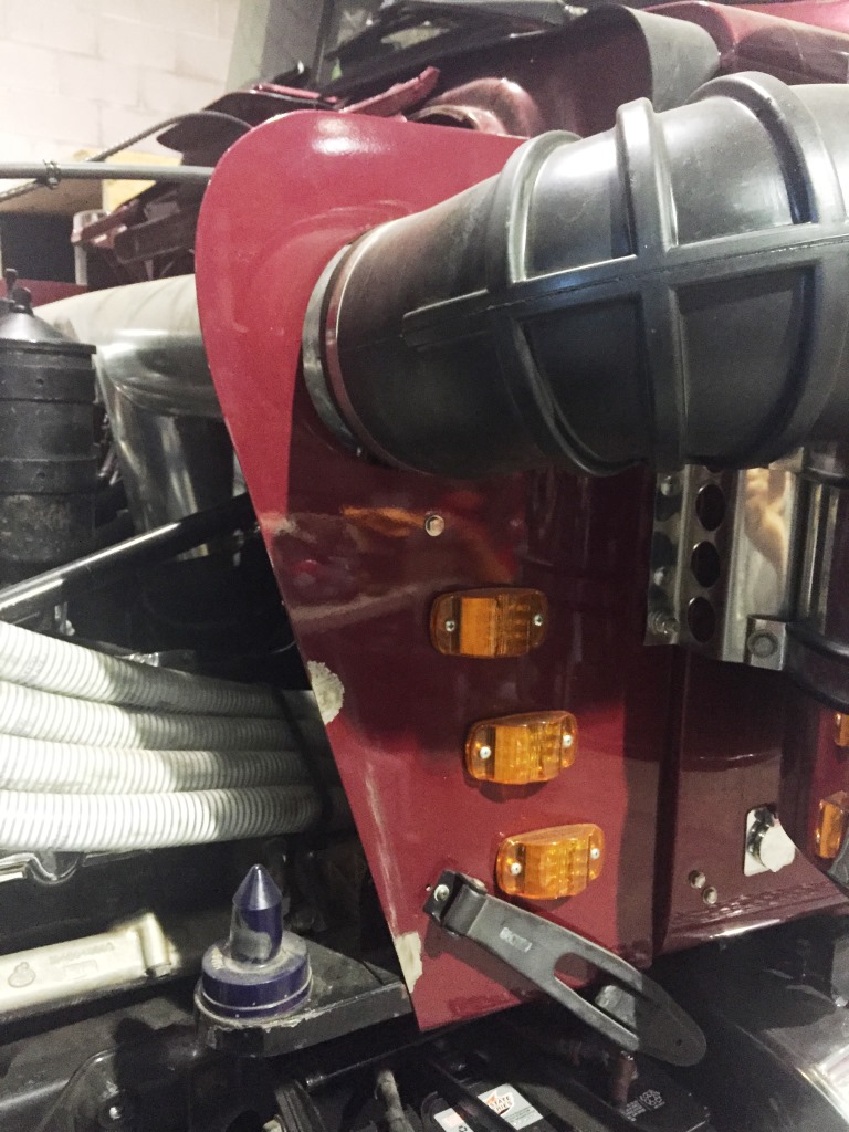

We mount our externals without cutting the hood.  You can hook both up or use just passenger side  and have drivers side for looks.  If you do both this way its tricky with the wiring panel on the firewall.  I can get a pick of it if you want.

Nice work on that set up. I have never seen one done like that before!
Agree.    I'd like to see some more pics of it.  Kinda look like they are mounted like a Pete.
