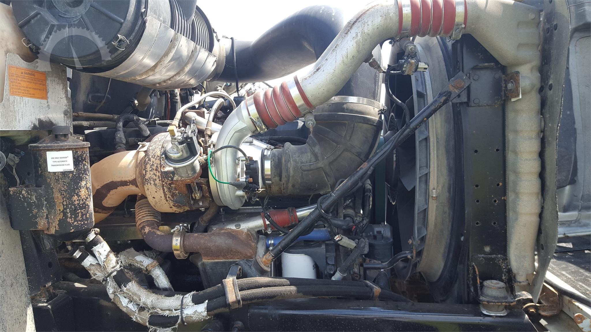

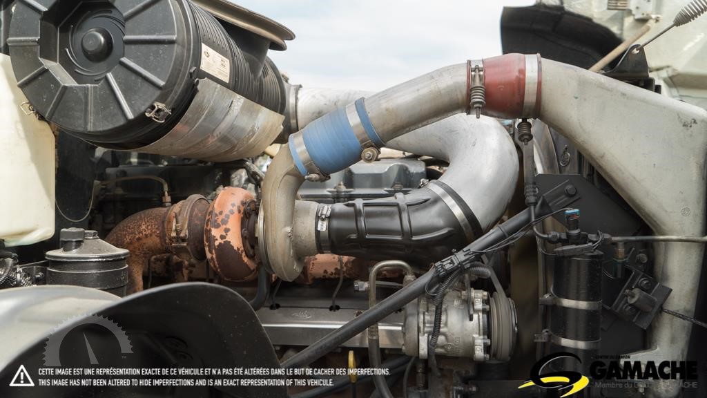

Simplicity is dead nidfd112. Two 2006 Mack 12Ltr pictured. Neither one was without issues, but man, what a mess of support systems on the AC. If I was vocational farm cash cropping, day trips, I'd grab an AI.
5982160fb3003_RightSideAC.thumb.jpg.e4ba930b04eca3adc218251298e6e1df.jpg59821621ef93b_RightsideAI.thumb.jpg.3437ac2850ef83c013164a78ff6b77b8.jpg
