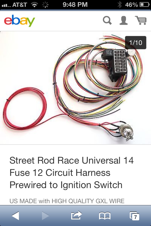

I used an ebay 14 circuit special $128.    (A few more extra circuits would have been nice).     I cut the relay and turnsignal flasher out of it and used my own seperate ones.(that made it only 12 circuits).  It was pretty easy install just a lot of time thinking through the process,  everything was labeled for a gas powered car not a diesel truck.   I probably  have about 25 hours in rewiring the whole truck.   http://m.ebay.com/itm/Street-Rod-Race-Universal-14-Fuse-12-Circuit-Harness-Prewired-to-Ignition-Switch-/282558337550?hash=item41c9ca120e%3Ag%3A9WYAAOSw7s5XgrMj&_trkparms=pageci%3A28875b1b-7a49-11e7-a3dc-74dbd180d7cb%7Cparentrq%3Ab53978d615d0ab64834a1cfeffffe713%7Ciid%3A1
