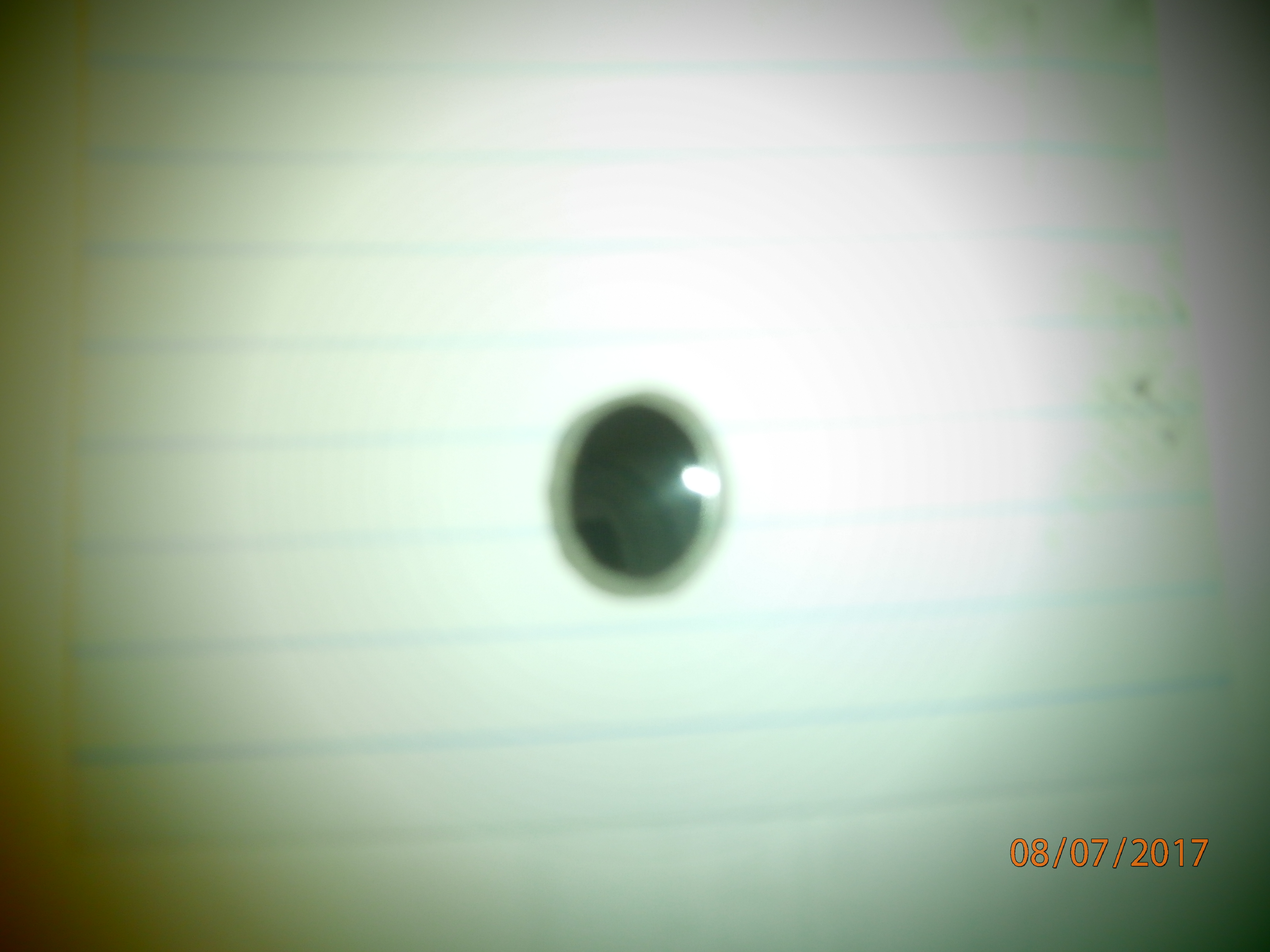

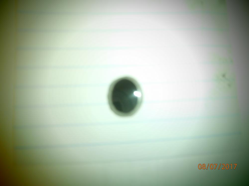

I've been having a fuel dilution issue on an engine. Liehberr Dealership Tech came up for a warranty diagnostic and high pressure fuel pump replacement. Guy was dabbing oil on white paper to find the "fuel halo". I grabbed an oil drop from a known good engine oil sample kit......same paper........no halo. I figure by the sample curve this drop has about 5%-7% dilution. Takes about 15 seconds to appear.

The drop of oil on a paper is not a new test.35 years ago at that time some of the old timers said they used it.It was to drop oil on a brown sack with a light behind it.I have tryed it a few times but did not find what i was looking for.Then some of them could smell of the oil and say yes or no.I do believe the paper test will work.

You can buy these oil sample test kits for personal use. They also have transmission, power steering and coolant test kits. Kits are very cheap. I'll look around to find the company.
Found it. Fluid RX.-A website called gwrauto.com is a distributor for Fluid RX. Looks like it might be cheap and reasonably accurate. They have various test cards that you can compare your samples with. I used to be in charge of the oil sampling program at a large nuclear facility. Sending samples out is very accurate but also very expensive. Turn around time may be too long for a problem truck. This test kit should allow you to take a questionable truck out of service very quickly until you can get the lab samples back. Should be a good tool for the hobby truckers. Quick and dirty. I think a lot of fleets use this test method.

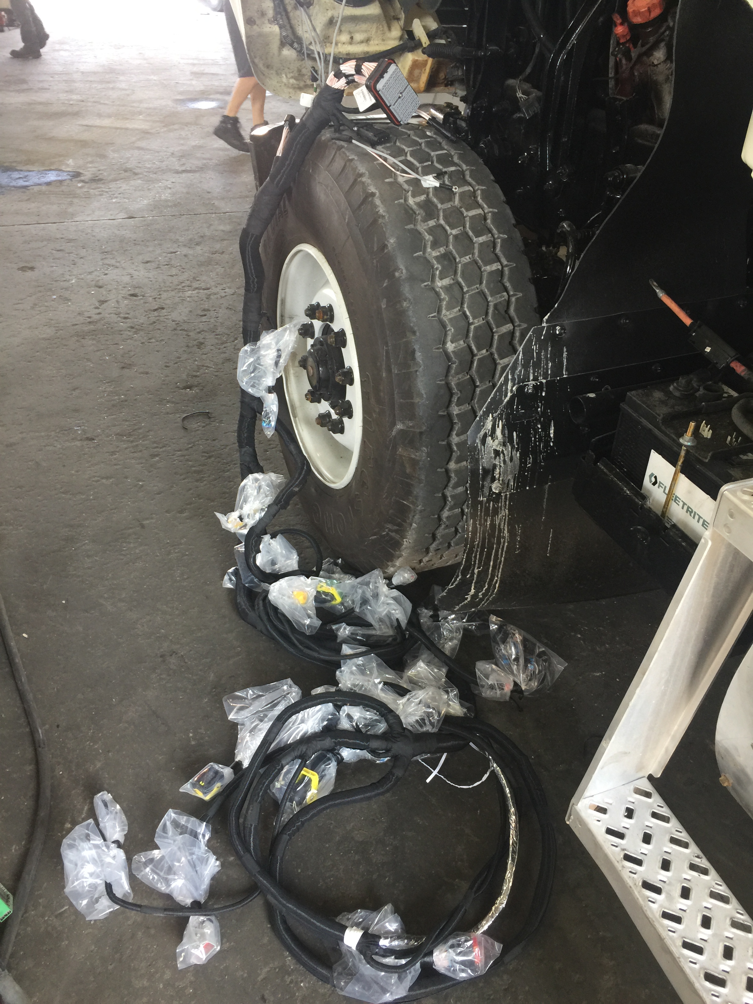

  On 8/9/2017 at 3:21 PM, Mackpro said:
However today its the dreaded "Chassis Harness of Death".  One of my all time favorites. Right up there with splinters under the finger nails! lol
Expand
Nasty. I want to beat it with a club so it can't harm my children.
https://www.bigmacktrucks.com/topic/50706-cool-engine-trick/#findComment-377178
  On 8/14/2017 at 3:54 PM, fjh said:
Yup Volvo Trash ! Id like to strangle the designer with it! I notice the newer engines have a proper plug at the valve cover thou  Step in the right direction,  One small step for Mack  Kind !
Expand
Yep , the common rail engines have a separate harness under the valve cover. But the chassis harness is still mostly one piece
