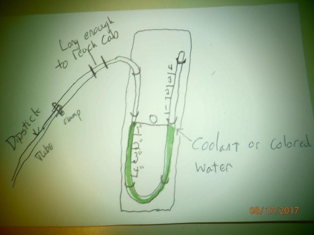

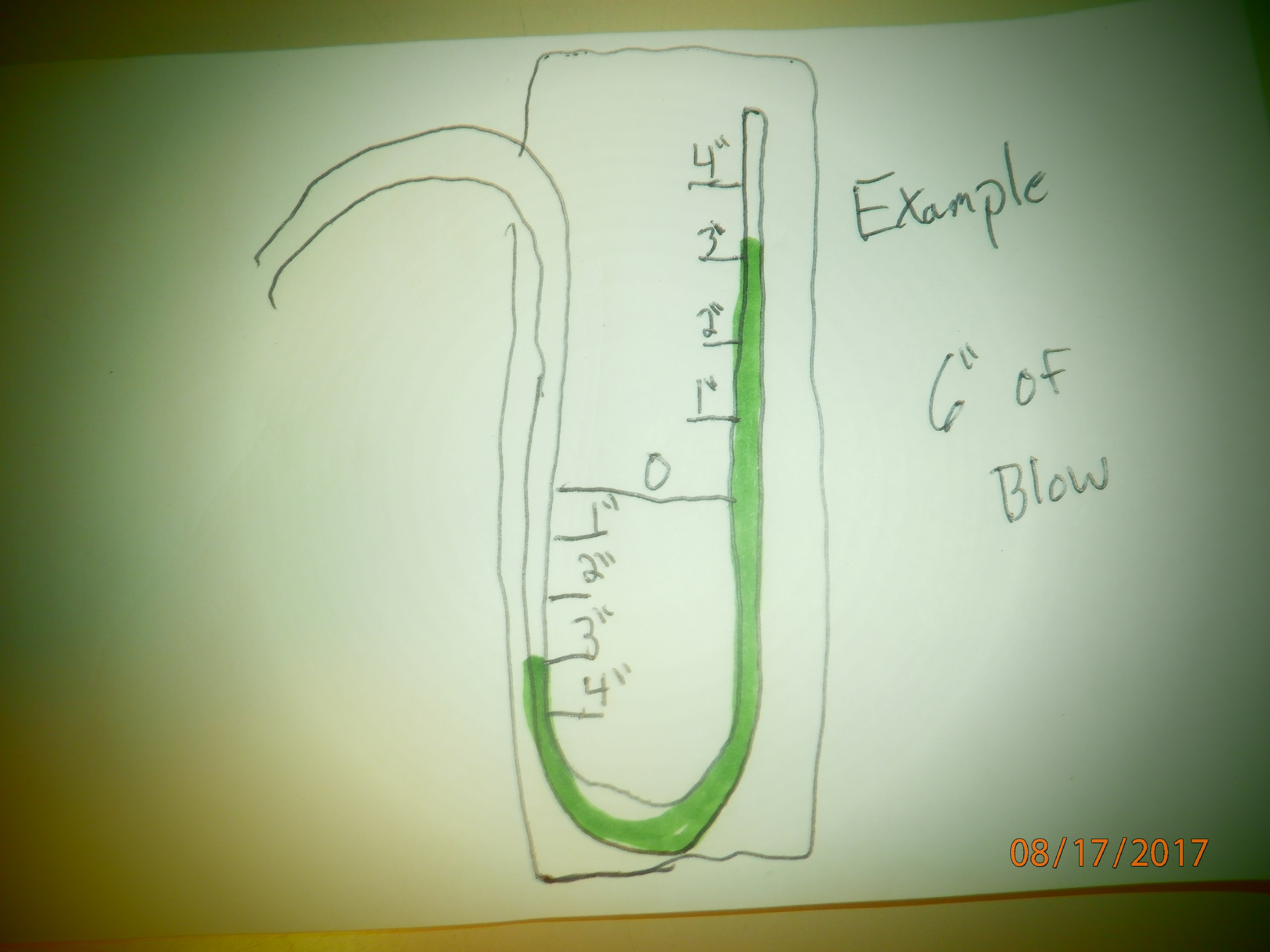

Build a poor man's manometer to tap into the oil dipstick. Find a clear piece of clear milk line that clamps over the dipstick, cut 14' feet of it. Make two vertical columns with a loop at the bottom with the top of one column hooked onto the oil dipstick and the other open to air then loosely U-staple the u-shaped line to a 3 foot piece of 2X6 board and mount it in the cab. Fill the loop half full with water and food coloring. Have your buddy measure the inch spread under load to check your blowby. Should be 6" spread or less for a tight motor.

You have to read at full govern and load. Have a partner in the cab interpreting. Our group expected Mack E7 to stay under 6" or we would be putting sleeves in. On the 80's engines you just look at the worm for your tach-out..LOL if you can't make the oil leak stop your crank is supercharged!!!!
You have to read at full govern and load. Have a partner in the cab interpreting. Our group expected Mack E7 to stay under 6" or we would be putting sleeves in. On the 80's engines you just look at the worm for your speed-o out..LOL if you can't make the oil leak stop your crank is supercharged!!!!
I don't understand the last sentence, but the image is very helpful.... you are a welcome asset here.... I think I like this idea so well because it looks like something a farmer would do.

On the E6 they didn't seal the tach drive gear. Operators with sloppy engines would come in complaining of a leak at that spot. The engine crank pressure would be driving motor oil out the tach drive and it was generally unfixable. A good indicator of trouble coming:). Manometer blow was usually high on these units.
