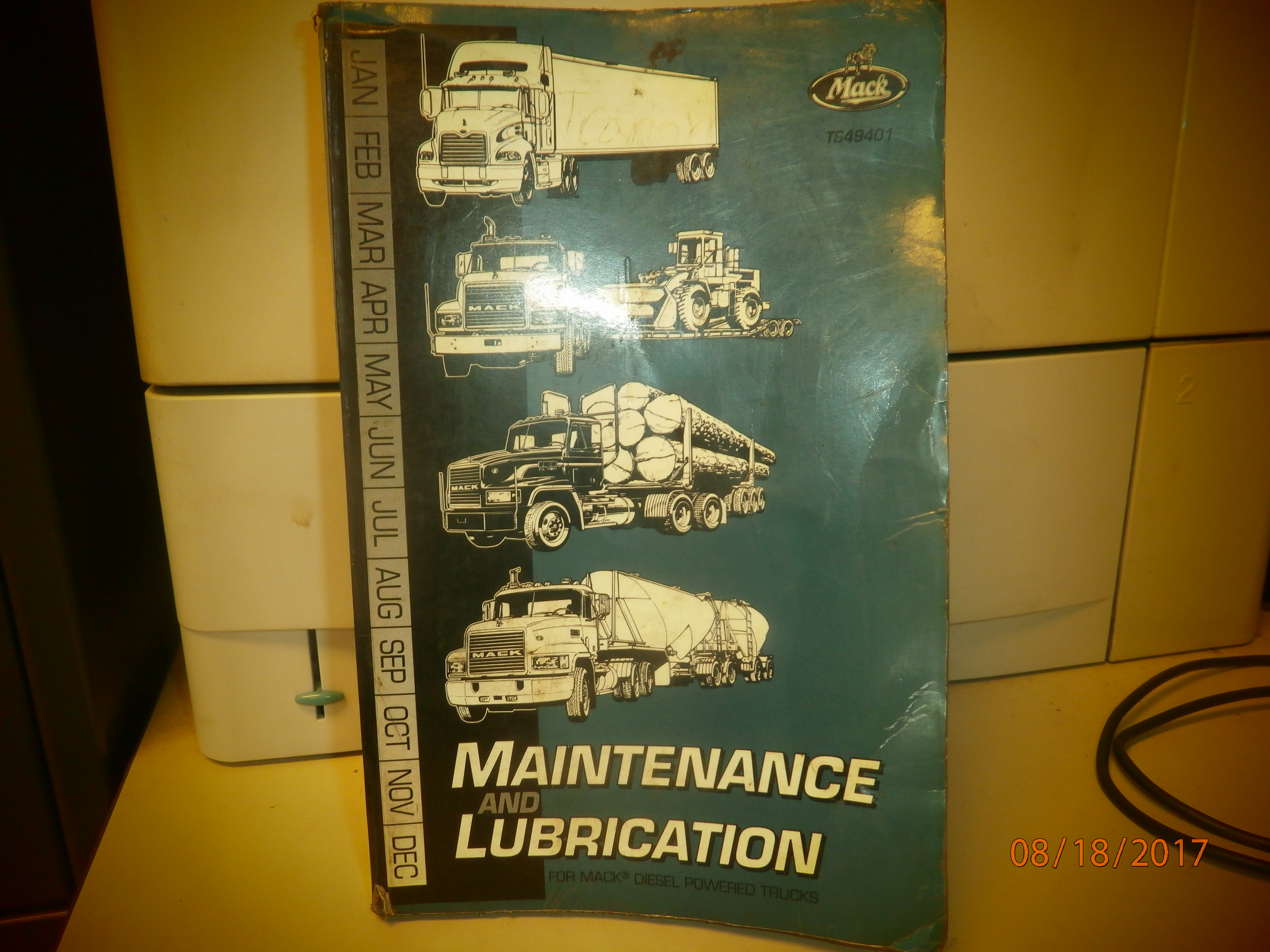

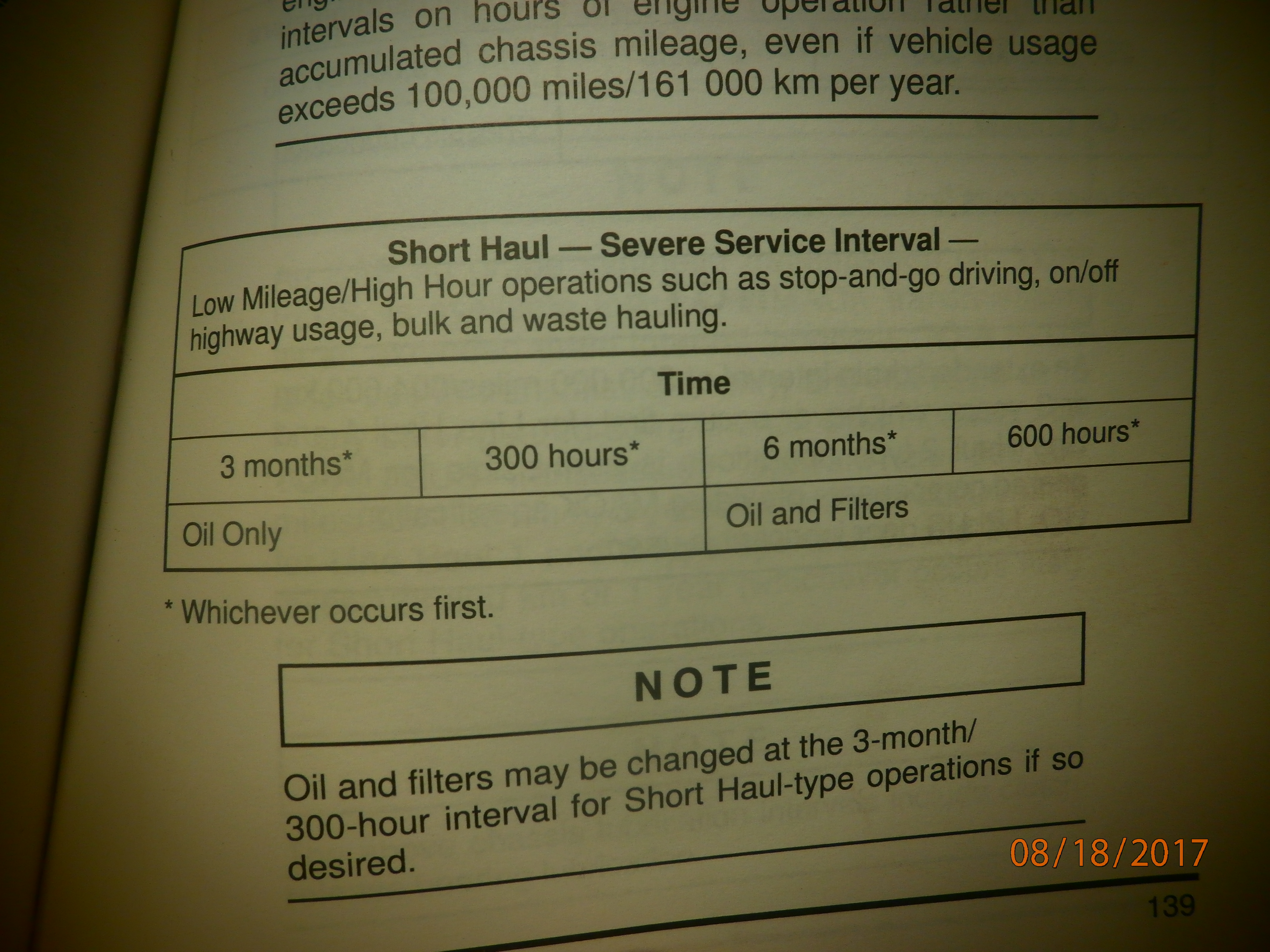

Mack's own recommendation ever since ESI has been 25,000 mile oil change. I have done 20,000 (mostly for easy math) with good results. 3 filters and 56 qts. IMO 10k is overkill. As far as filters go, the Mack filter kit box has always been the cheapest way to buy filters. 25 years ago, my former employer did some research on filters, and found that WIX used recycled BANANA PEELS as filter media! He nor I ever bought WIX filters after that!
